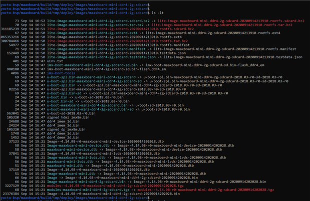

    I am attempting to use the eMMC version of the MaaxBoard mini (instead of sdcard version).
I reviewed documentation on that, but I need additional help.
Summary:
The manual to burn the image to eMMC was written in 2019 and it is for IMX8M (MaaxBoard – not Maaxboard mini).
https://www.element14.com/community/community/designcenter/single-board-computers/maaxboard/overview?showTab=2&
https://www.element14.com/community/docs/DOC-93781/l/aes-mc-sbc-imx8m-g-developmentguide-emmc-v10pdf?ICID=maaxboard-datasheet-widget
The document directs you to use "uuu" tool from NXP, and plug in various files from the Linux build:
However, these files do not exist when you build Yocto image for MaaxBoard MINI
(using directions to build Avent Yocto for MaaxBoard MINI).
u-boot-imx8m-uuu.imx
u-boot.imx
EM-MC-SBC-IMX8M-Yocto-Image-SDcard-V1.0.2b03.img
uuu_list.lst
Files producted by Yocto MaaxBoard Mini Build are:
  • jafoste4
    0 jafoste4 over 5 years ago
    Hi Arthur,
    I talked with my colleague about this, he suggested just to burn the SDCARD verison image onto the eMMC. That should work no problem.
    Let me know if you are still having issues and I can dig further.
    -Josh
