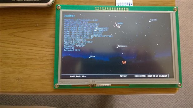

    Tried the TI image screen light up red light on the cape flashed imagescreen gave a weird pattern with a line across the middle and slowly went dark but the back light is on any suggestions?
  • rattustrattus
    0 rattustrattus over 12 years ago in reply to rattustrattus
    Ignore that I am an idiot ... forgot the size line .... so shows display/hardware fine me stupid .... need to fix the last part probably end up putting debian on it ....
    Thanks for your help
    0 e14 Contributor over 12 years ago in reply to rattustrattus
    You're welcome. Main thing is that you now know the display works, so you can take some time to get it all setup the way you want with an OS that suits you.
  • rattustrattus
    0 rattustrattus over 12 years ago in reply to e14 Contributor
    FYI got it working ... at last, I stole the kernel and initial boot from the TI demo image, and stuck a debian rootfs on that, I don't get the cape manager as a result, but with the addition of having to build fbdev and evdev input device and custom X11 config files, I now have stellarium running image. So it can be done.
    So anyone trying it with a White Beaglebone it is possible,

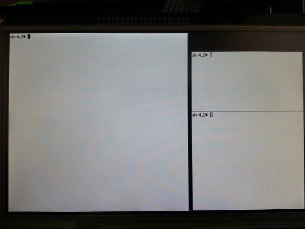

    Hi,
    I do as you write here and I am able to initially lunch my LCD.
    echo BB-BONE-LCD7-01:00A4 > /sys/devices/bone_capemgr.7/slots
    It shows me Angstrom login screen. I can log in (I set autologin). But can't startx. From this site I learned to use "fbdev". I modify my xorg.conf, 10-evdev.conf etc. But still no success. I mange to see white screen with mouse on the middle. And nothing more. Author of this topic manage to merge TI with Angstrom Image, but unfortunately for me I don't know how to do it. I am still a beginner with embedded, but I hope with time it will change.
    If I install TI-SDK image, LCD works well, but I want to lunch there normal system, not SDK.
    Here is my error: (I try to search internet for hints with twm and xclock, but no success ;/

    I manage to push it forward a bit. Now there are no errors. But all I get is a white screen with working shell ;/ My mouse is working and my keyboard works too. So maybe I am wrong and all i should get from this Angstrom is only this white screen with shells? Here is my screen:
    And my logs:

    Pawel,
    looks like you need to run a window manager, I haven't bothered for what I am doing because I wanted the application to be the only one running. So just start the X server then run the app on it.
    If you look at your log its trying to run twm which is an old window manager if you install it you should then get your windows with frames.
    Kevin
  • pawel_krzy
    0 pawel_krzy over 11 years ago in reply to rattustrattus
    It works image
    thx for tip. My window manager was previously working and was active. So I didn't blame him earlier image All I need to do is to restart it. If someone will have this problem with BBW write here image.
    PS. Here is my script to lunch BBW with newest (08.10.2014) Angstrom image: (you have to change xorg.conf file also)
    #!/bin/bash
    sleep 5
    startx &
    sleep 8
    systemctl restart gdm
