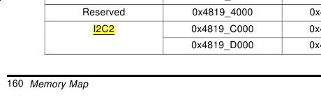

    root@beaglebone:~# ls -l /sys/class/i2c-dev/
    total 0
    lrwxrwxrwx 1 root root 0 Jan  1 00:00 i2c-0 -> ../../devices/ocp.2/44e0b000.i2c/i2c-0/i2c-dev/i2c-0
    lrwxrwxrwx 1 root root 0 Jan  1 00:00 i2c-1 -> ../../devices/ocp.2/4819c000.i2c/i2c-1/i2c-dev/i2c-1
    the cape eeproms are 4 devices at 0x54-0x57 on /dev/i2c-1 which is the i2c bus at 0x4819c000.  In the TRM you'll find
    Showing that /dev/i2c-1 is the peripheral named I2C2.
    Remember that my look into the same directory on a different image had
    lrwxrwxrwx 1 root root 0 May 25 17:39 i2c-2 -> ../../devices/ocp.3/4819c000.i2c/i2c-2/i2c-dev/i2c-2/
    which clearly shows you can't use the /dev entry to work out what pins are actually going to be used, and that you get different results from a different base dtb file.

    showing how the cape eeproms are tied to the physical peripheral regardless of /dev entries.

    Also, when reviewing listed i2c devices I don't see i2c at 0x4819C000 after BB-View install, I only see it prior to install.
    Note, I did nothing else besides what's described in the manual. In my case it is definitely the case that installation of BB-View is removing I2C interface and is not due to any messing around with base OS install (besides what's stipulated in user manual).
    My understanding is that the I2C on pins P9-19/20 are primarily for use by system for 'discovery' (my words) of capes and capability and can be used by other processes as long as there is no conflict in I2C addressing. It appears to me that BB-View not only doesn't support cape eeprom but also disables it removing this capability from the system - to me this is a degradation of BBB ecosystem and doubt it would be considered as a compatible cape (maybe I totally misunderstand, but clearly the i2c support is missing and in it's place I have a rather (resource) expensive led that I can toggle).
    If there is another way to install BB-View (as you seem to be suggesting) then I'd really like to look into that, else it may be time to RMA devices ordered and look for more suitable (for this project) LCD solution.
    Again, I appreciate your time on this, I am definitely learning more and hopefully this can help others as well.
