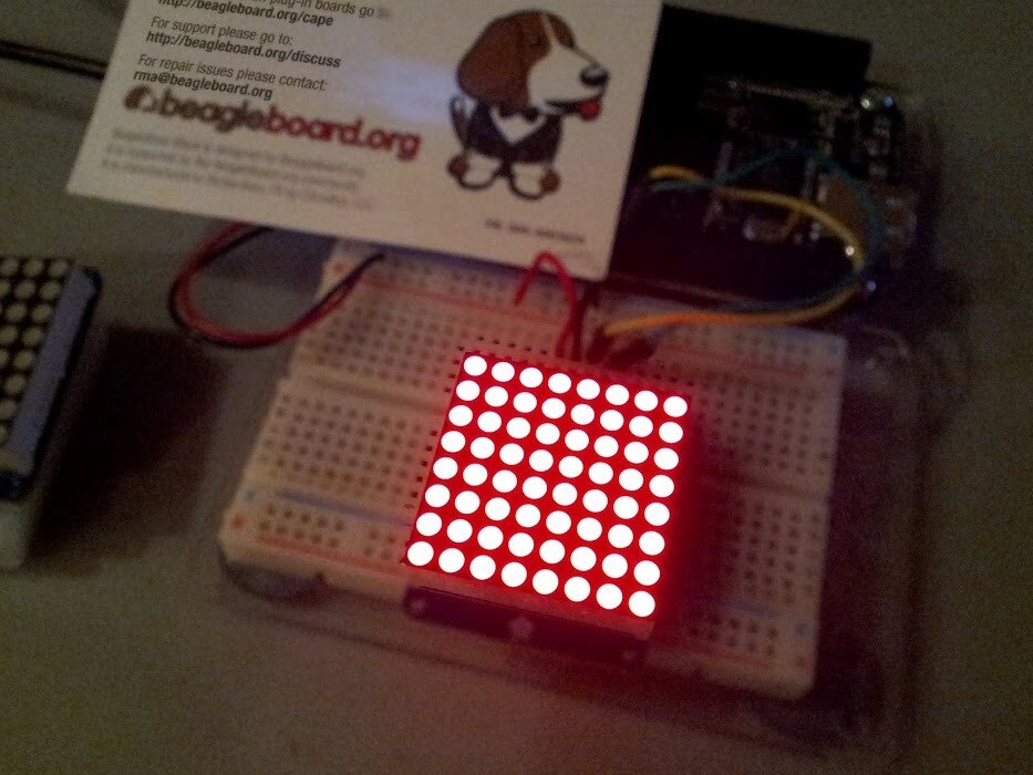

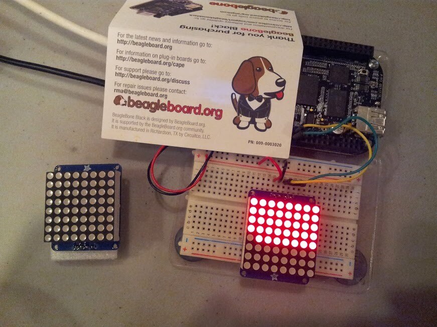

Similar to my previous post on Interfacing BeagleBone Black with Adafruit 7-segment LED display, I have hooked up the Adafruit 8x8 LED matrix with I2C "backpack" .  This means the matrix is connected with just 4 wires (3.3VDC, GND, SDA, SCL) to the BeagleBone Black (e.g. BBB) which is mounted on the Adafruit BeagleBone Black Proto Plate :
And like with the 7-segment LED "backpack", the Python module that Adafruit wrote for the Raspberry Pi works with the BeagleBone Black as well (hooray for the common abstraction of Linux and Python image):
https://github.com/adafruit/Adafruit-Raspberry-Pi-Python-Code/blob/master/Adafruit_LEDBackpack/Adafruit_8x8.py
I shot a video of it running the Adafruit_8x8.py example program:
Adafruit 8x8 LED matrix controlled by BeagleBone - YouTube
I'm looking forward to putting this display to use in a project.
Cheers,
Drew
