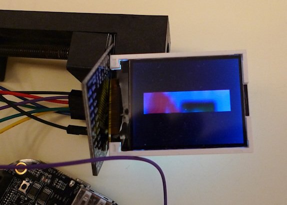

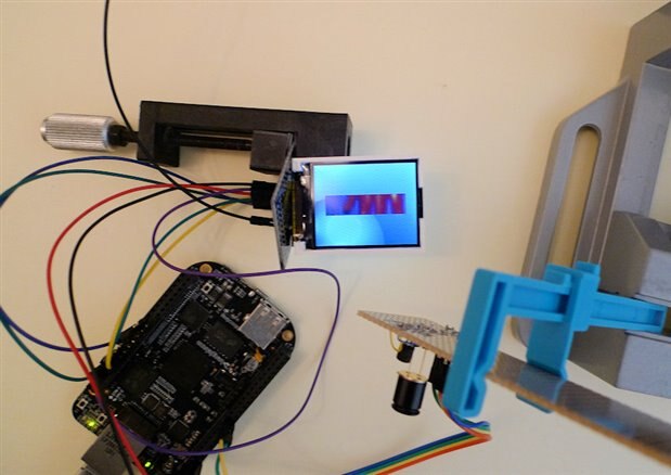

This was a quick, fun exercise, to build a complete thermal camera using the Beaglebone Black, a small LCD and a thermal array sensor.
It was really more of a consolidation, combining some earlier experiements.
The setup
The image here shows the entire assembly, capturing an image of my hand (taken from about 1 foot away. It was hard to take a photo at the same time!).
The final code is attached. The information on each sub-section is at these links:
Thermal array circuit
I2C interface code (either compile it, or just copy the libi2cfunc.a file to /usr/lib, and the i2cfunc.h file to /usr/include )
1.8inch LCD display
Image scaling (or use NEON functionality)
PRU information (you will need to install the PRU assembler if you want to make changes - if you don't, you can use the pre-assembled .bin file in the zip file).
The attached code is not tidy, but it works. It could be optimised a lot, I made no effort to do this. Currently the image updates at about 1Hz, but this could be improved many times. Many conversions are done that could be simplified.

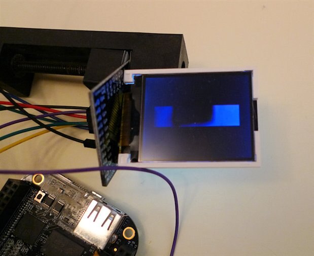

Edit: It looks like actually the whole process is occurring at many tens of Hz, but the LCD updates at about once per second; this looks like a limitation of the LCD display (the update over the serial interface is occurring rapidly, but internally it presumably only updates once per sec. An alternative display is required!).
Edit 2: It turned out that the LCD was fine; the thermal sensor was set to internally update at 1Hz, regardless of the readout speed. The version 2 code attached has it now set to 16Hz in ir.c, but possibly 4Hz or 8Hz would be sufficient and give higher accuracy.
