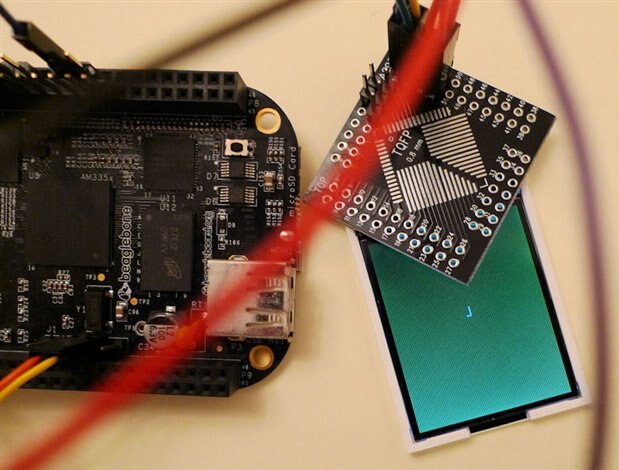

This was rather easy, now that we know how to use the PRU to send high speed data (at least for GPIO1 currently). I just used a random color LCD and it worked fine.
The vendor electronics_lee on e-bay is selling lots of serial mode LCD displays (for less than $7 including free postage) of the type used in normal mobile phones (i.e. non-smartphones). The nice thing is that they can be run at a very high speed, so that video is possible if desired. It uses Sitronix ST7735 as the driver.
Currently the PRU code is used to initialize the display, set it all to a single color (green in this example) and then write the character 'L' to the center of the screen just as a test.
The entire screen is written in just tens of millisec, and it would be possible to speed it up further (I didn't read the datasheet closely for the timing specs). It would be good to get the PRU to populate the display based on RAM filled by software running on top of Linux, but I ran out of time to work on that (it should be simple to do).

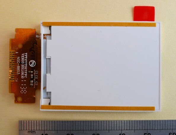

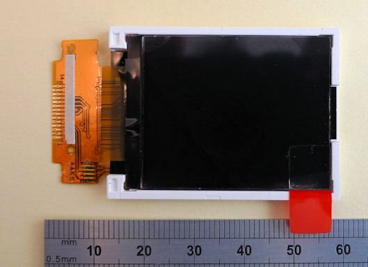

The LCD is rather small (128x160 pixels, 34mm x 46mm in size, about 3mm thick) unfortunately, but good enough to display status information or a simple graph.

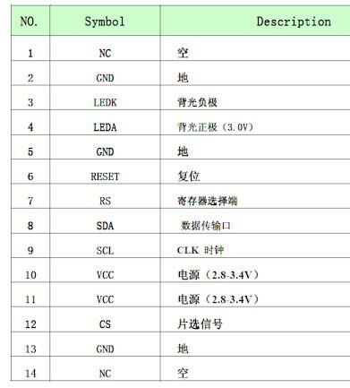

The LCD has only 14 pins, of which a couple are not used, and the GND pins are connected together already (the two VCC pins do need to be connected). The LED was connected to the 3.3V supply via a 100 ohm resistor, and the whole thing was powered from the BBB 3.3v supply.
The LCD looks like this unsoldered. Notice the small white strip, which is adhesive tape. This is used to stick it to the PCB to keep it in position while soldering (and then the display is folded over, so that the soldered flex is underneath the display).

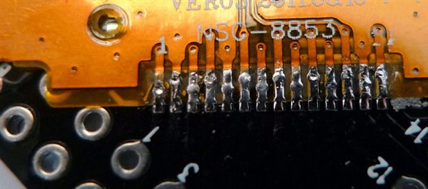

The flex cable on the LCD has pins spaced 0.8mm apart, which was a perfect fit using one row of pins on a TQFP breakout board (it would be nice to make some custom PCBs for this display).
The photo above shows it soldered to the breakout board. It can be done with a normal soldering iron and normal solder, but if you have solder paste it makes it even easier. A really extremely tiny amount of the paste is spread in a line over the pads on the PCB, the LCD flex is stuck down with the adhesive tape in the photo earlier, and then a soldering iron is just stroked on top (outward, in the direction of the pads) to allow the paste to melt. There are small holes in the flex pads, so the solder will go through, so you can clearly see that it soldered correctly.
Viewing direction: I never understand how the clock system is used to specify the viewing direction on TFT displays, but basically the view appears best in landscape on this LCD, not in portrait. In portrait the screen goes bright/dim depending on if I look at it from above/below. In landscape it is much better. The backlight LEDs are on the edge closest to the flex cable.
This was the connections to the BBB, in order to use the attached PRU code:
LCD pin          Description          BBB header pin          Control reg Address
2,3                  GND,LEDK              P9 pin 1
6                    RESET                 P8 pin 26               0x44e1087c
7                    RS                    P8 pin 12               0x44e10830
8                    SDA                   P8 pin 16               0x44e10838
9                    SCL                   P8 pin 15               0x44e1083c
10, 11               VCC,VCC               P9 pin 3
12                   CS                    P8 pin 11               0x44e10834
LCD pin 4 (LED Anode) is connected to VCC via 100 ohm resistor.
