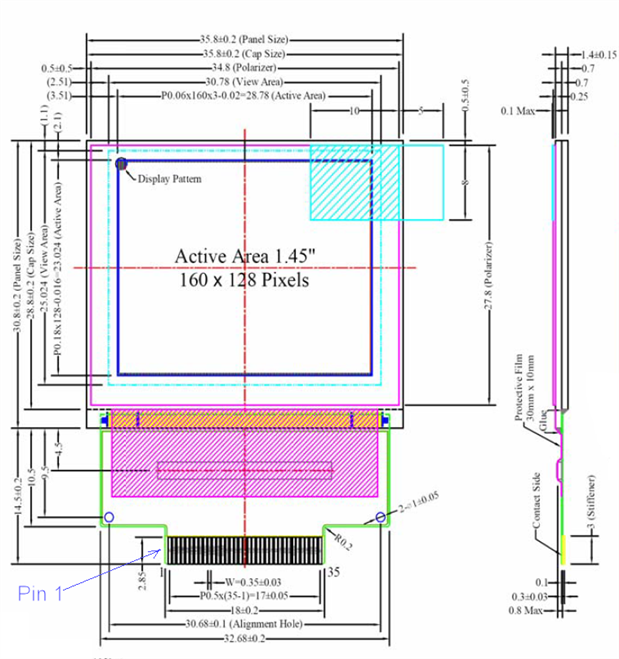

The display has a Densitron code DD-160128FC-1A. The screen has the label “UG-6028GDEAF01” on the rear. A connector by Omron (Omron code XF2M35151A  Farnell code 1112561) should fit.
Shown below is a diagram from the datasheet. The screen is very thin (about 1.5mm). There is an in-built controller (Syncoam SEPS525) located in the hatched purple area. The display is organized such that memory address 0 is top-left (where the round blob is shown) like most displays. Personally I prefer to have the origin at bottom-left, so the code uses that reference point as (0,0) instead of top-left.

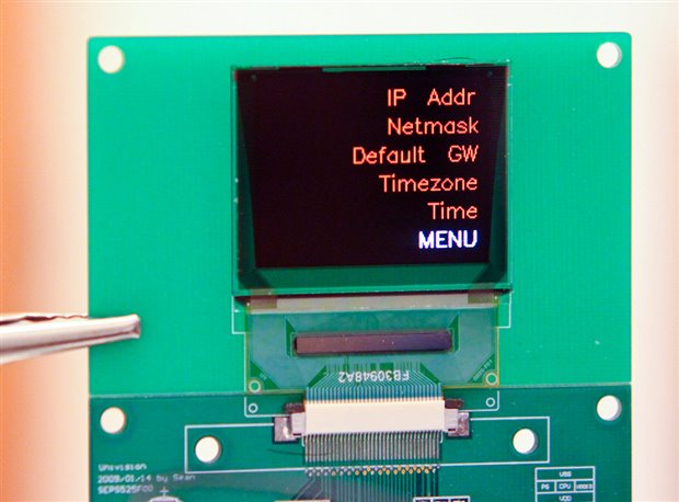

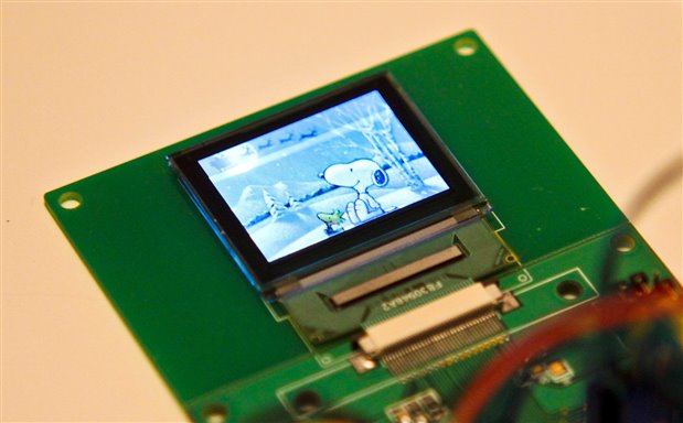

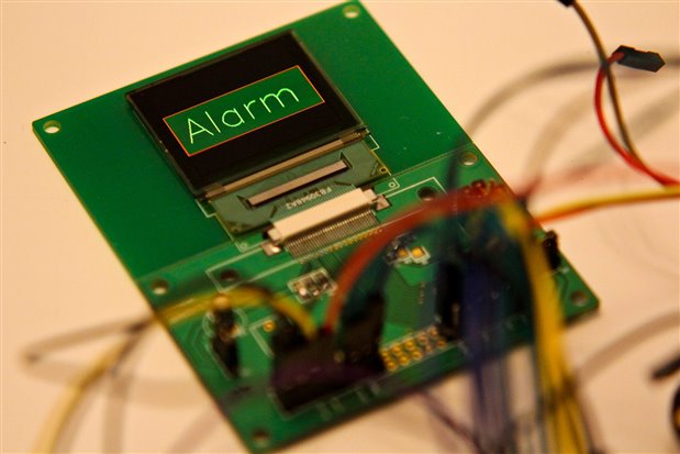

Example Images

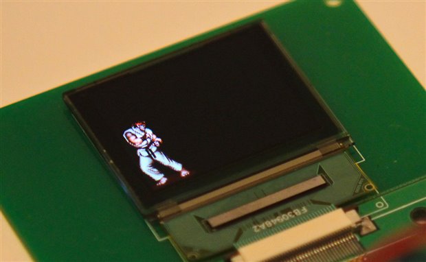

These photos were taken in a brightly lit room. The screen appears bright, sharp and has a more rich/saturated quality than LCD displays:
This animated character is drawn at position (0,0), since co-ordinates are taken from bottom-left in the attached code:
An example menu. A circuit board could have buttons to the side:

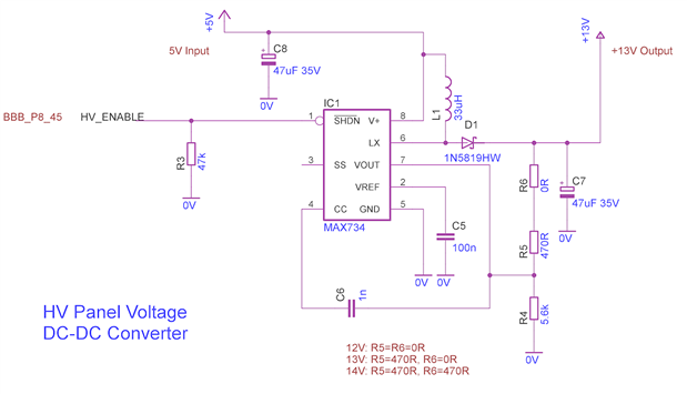

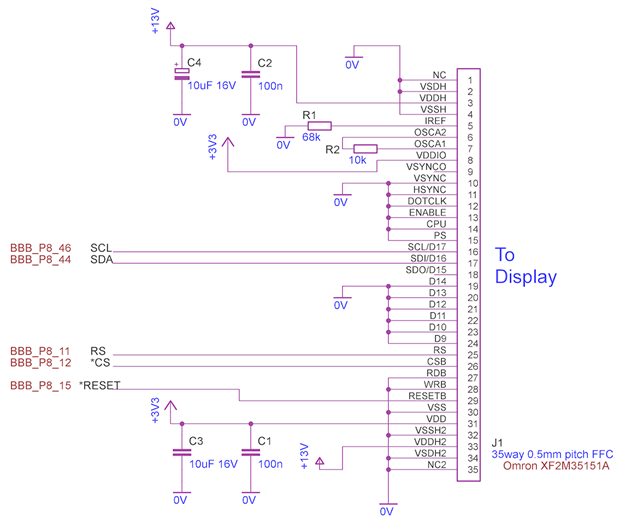

Circuit
There is an optional demo board available, but it is quite basic; it has no active components, it is almost just a breakout board. The demo board was intended to speed development up, but the datasheet slowed things right back down again - the datasheet from Densitron is poor and has many errors (they have taken absolutely no care to review it).
This is the required circuit to get the display working in a serial mode:
An appropriate connector shown here (Farnell code 1112561) should be compatible (35 way, 0.5mm pitch) but was not tested.
The display requires a low voltage supply (3.3V max) which matches what the BBB offers. A higher voltage (13V) supply is also required. I didn’t have any appropriate IC over the holiday period, so a Maxim MAX734 was used, with some resistors used to adjust the voltage to 13V. This is not recommended since it is outside the specification of the MAX734, but the circuit is shown below since it worked for the prototype. It is recommended to use a different circuit.
Once assembled, the circuit was connected to the BBB as indicated in the schematic. The 0V, +3.3V and +5V supply rails were powered directly from the BeagleBone, using the BBB header P9 pins 1, 3 and 5 respectively.

    shabaz over 11 years ago in reply to e14 Contributor
    Hi Mohit,
    800mA is a huge amount (>20 times expected) so it could have caused a permanent fault.
    The datasheet does mention that there is a power supply sequence, and the 13V supply should not be switched on unless the 3.3V supply
    is already present. As you say, probably even +5V should not be present on that pin until the 3.3V is supplied.
    There are not many DC-DC converters will full shutdown capability, so probably the best way is to use a MOSFET to switch the power on that pin.
    Apologies that was not clear in the post, although I did make it clear that the 13V supply needed complete rework since I just used whatever was
    at hand (it was at Christmas time 18 months ago : ( and no chance to order any bits : ( and the shutdown signal I used would not have
    removed the 5V supply minus the diode drop. It was an oversight on my part.
    But definitely 13V should not be enabled before the 3.3V supply.
    I still have my display and do intend to still use it, and will be revisiting the 13V driver portion at some stage. But if you get there before me,
    please do share your circuit.
    Also, for future, definitely set a current limit on your power supply before switching on such circuits. This is all experimental prototype stuff (and OLED
    display datasheets are generally poor) so best to take some precautions during prototyping.
    Thanks.

    shabaz over 11 years ago in reply to koolkat204
    The first question is, what problem are you trying to solve? From your trace, both the SCL and SDA lines are changing, so the iolib would be appearing to work. You'd need to verify any remainder wires are working as expected, and confirm that there is no short or anything causing the SCL and SDA lines to both appear as if they are changing simultaneously.
    Also, can you confirm using zoom-in and pan, that the signals are behaving as expected? If not, you can write some short code to test each line separately - not just the SCL/SDA but all relevant lines. In an earlier trace you captured (I think the second one that you posted), the SDA and SCL signals do have a difference, so something has changed in the testbed or code, or you are capturing a different point in time, or the logic analyzer needs to be zoomed-in.
    Also, I would exit out of logic analyzer mode and just confirm that the signals have the correct voltage levels and are not being loaded too much or anything.
    If/when you decide you do need to change the library, the OLED code does not use the capabilities in the files you have mentioned above, so they are not essential but you may need to modify the makefile or some places where the files may be included. I have not done this, so you would be trailblazing, but it is possible, but would need you to inspect the code and just try compiling and resolving issues one at a time.
