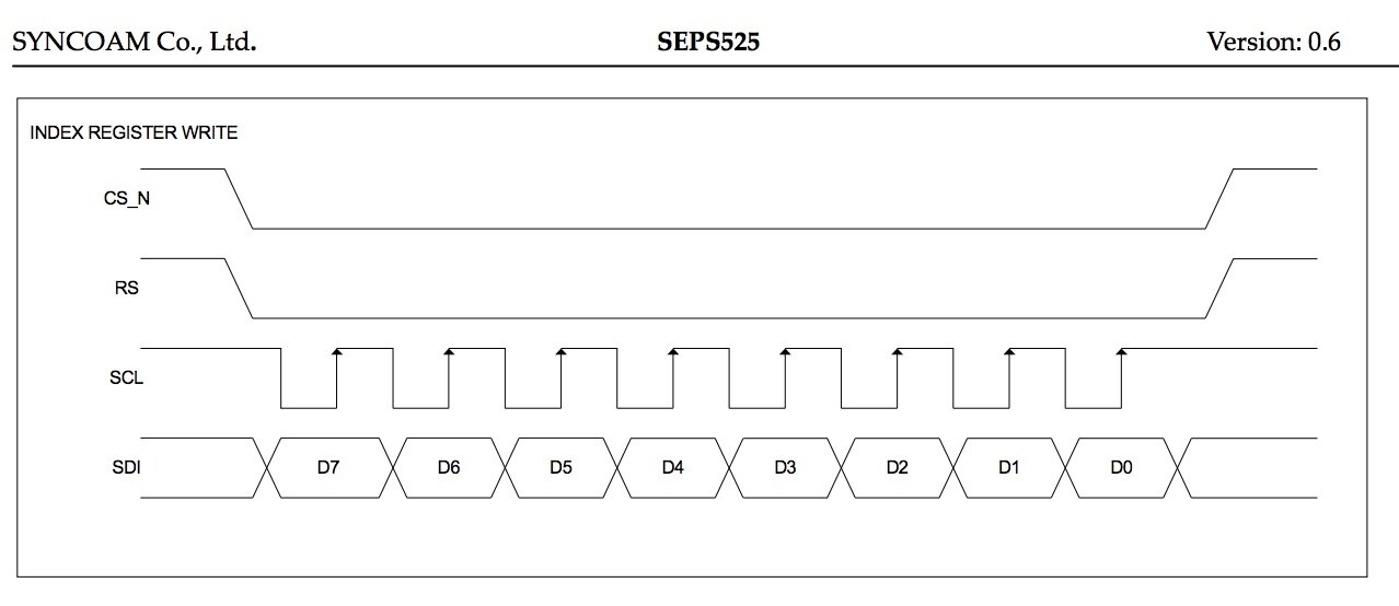

The display has a Densitron code DD-160128FC-1A. The screen has the label “UG-6028GDEAF01” on the rear. A connector by Omron (Omron code XF2M35151A  Farnell code 1112561) should fit.
Shown below is a diagram from the datasheet. The screen is very thin (about 1.5mm). There is an in-built controller (Syncoam SEPS525) located in the hatched purple area. The display is organized such that memory address 0 is top-left (where the round blob is shown) like most displays. Personally I prefer to have the origin at bottom-left, so the code uses that reference point as (0,0) instead of top-left.

There is an optional demo board available, but it is quite basic; it has no active components, it is almost just a breakout board. The demo board was intended to speed development up, but the datasheet slowed things right back down again - the datasheet from Densitron is poor and has many errors (they have taken absolutely no care to review it).
This is the required circuit to get the display working in a serial mode:
An appropriate connector shown here (Farnell code 1112561) should be compatible (35 way, 0.5mm pitch) but was not tested.
The display requires a low voltage supply (3.3V max) which matches what the BBB offers. A higher voltage (13V) supply is also required. I didn’t have any appropriate IC over the holiday period, so a Maxim MAX734 was used, with some resistors used to adjust the voltage to 13V. This is not recommended since it is outside the specification of the MAX734, but the circuit is shown below since it worked for the prototype. It is recommended to use a different circuit.
Once assembled, the circuit was connected to the BBB as indicated in the schematic. The 0V, +3.3V and +5V supply rails were powered directly from the BeagleBone, using the BBB header P9 pins 1, 3 and 5 respectively.

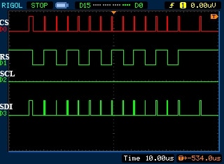

  • koolkat204
    koolkat204 over 11 years ago
    Hello shabaz,
    Please have a look at my Scope screen shots, I believe there is a issue with SCL.
    Thanks!
    shabaz over 11 years ago
    Thanks for the photos. I'll try to compare with the datasheet, just in case.
    One more thing, are these cables you crimped yourself, or purchased? One batch I purchased had quite a few bad connections, I had to throw out some of them. Might be worthwhile quickly buzzing out each cable (against the exposed metal bits on the sides of each cable end) with a multimeter to confirm all are good - it shouldn't take long of course.
    shabaz over 11 years ago in reply to koolkat204
    Hi Paul,
    Unfortunately I can't think what else could be wrong. If you've checked supplies then the next thing to check is with a scope to make sure that you are seeing signals correctly.However the OLED displays in general have extremely bad documentation, so I'm wondering if yours is somehow sufficiently different that it doesn't work. Could you show a photo of your testbed, in case there is something easy to spot?
  • koolkat204
    Hey shabaz,
    Any idea whats going on?
