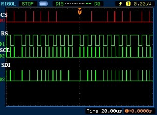

    shabaz over 11 years ago in reply to koolkat204
    Hi,
    That's great that the SCL problem is fixed! Now I look at the code (it has been a year so I've forgotten most of it) I see there are parameters for the OLED, like precharge current, precharge time,  driving current, etc. Looking at the Newhaven datasheet, their values are very different. So it seems that these would need to be adjusted to suit your display. The settings are on lines 38-71 in the source code (and the definitions are in the header file).
    After that, it may work ; (

    koolkat204 over 11 years ago in reply to shabaz
    Hey shabaz,
    I switched pin 46 (SCL) to pin 43, now I am seeing activity image, unfortunately still no life on the display yet.
    Also, from your scope trace, it looks like maybe you're looking at multiple bytes, right? Could you zoom in just to see one byte transfer, in case the SCL is toggling but not easily visible at the wide view.
    I see. Ok, I think we're making progress, the scope trace definitely helps!!
    I'm wondering if it is perhaps pull-up related, although it shouldn't be. I've not got the AM3359 TRM at hand, but as a quick test, a weak pull-up (e.g. 33k resistor between the SCL pin and +3.3V will help identify if the pin is programmed correctly (it should be, because this code worked for me - but perhaps my OLED board has internal pull-ups). I don't have my OLED testbed any more, otherwise I'd reattempt.
    As another thing, in the code (on about line 200) you can see where the pins are configured:

    The header file contains the definitions for SCL which will need to change too:
    #define SCL_LOW pin_low(8, 46)
    #define SCL_HIGH pin_high(8, 46)
    I suppose as a first test you could just swap the definitions for SCL and SDA, and rerun the code, and you should then see activity on the SCL but not on SDA. I can't see why the pin for SCL isn't working : (
    Hey shabaz,
    The scope screen shot was directly attached to the BBB (no display). I downloaded the Angstrom image, same results.   : (
