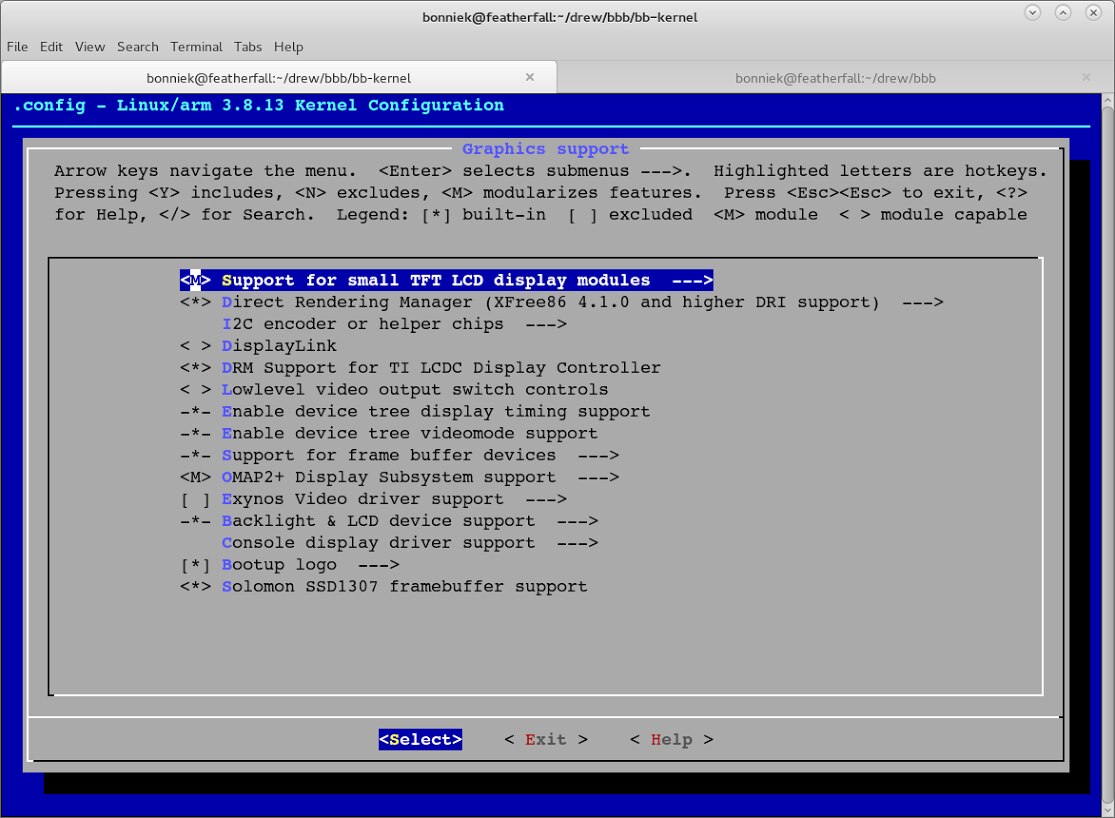

The kernel config menu should appear shortly after starting the rebuild script.  Follow these screenshots to select the fbtft drivers:
After exit the kernel config menu, the rebuild script should continue:

  • My screenshots of kernel config for fbtft drivers in BeagleBone kernel v3.8.13
