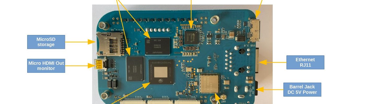

BeagleV Ahead board back components location
Feature
Description
DA9063
Dialog semi Power Management Integrated Circuit (PMIC)
microUSB 3.0
Power & USB connectivity as client or Host (OTG)
Antenna connector
2.4GHz/5GHz uFL connector
AP6203BM
Ampak WiFi & BlueTooth combo
DSI
MIPI Display connector
CSI0 & CSI1
MIPI Camera connectors
TH1520
T-Head quad-core C910 RISC-V SoC
Mini HDMI
HDMI connector
microSD
Micro SD card holder
4GB RAM
2 x 2GB LPDDR4 RAM
