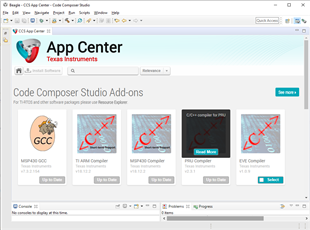

Download and install CCS. Make sure that you select the Sitara option as that's what we're targeting. Note that if you're adding Sitara to and existing CCS installation, you will need to make sure you have exactly the same version of the installer otherwise you'll be forced to do a new installation. Once it's installed, go to the App Center and add in the PRU compiler.

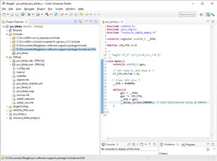

This support package contains the header files you need and also some nice examples in the example/am335x folder. I suggest you pick an example (such as PRU_gpioToggle) to start from. The critical part is that the include and include/am335x folders have some essential stuff.
So, here is our blinky project. The things to take note of are:image
  • our main C file It's not doing much - just toggling a bit in the PRU output register R30.
  • resource_table_empty.h I haven't dug into what this file is for (yet) but it does seem to be needed.
  • other referenced header files in the PRU support package.
You can of course build your project from scratch. I did, following this TI PRU Training. However, this assumes that you'll be deploying and debugging with an XDS-110 emulator - which I'll hopefully be doing soon! Note that it also leaves out resource_table_empty.h even though I found it was required. Some very useful current info in there though.

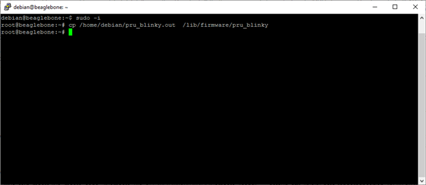

Copy your firmware to the PRU
Your out file needs go be copied to a special firmware folder to be accessible.
sudo -i
cp /home/debian/pru_blinky.out /lib/firmware/pru_blinky

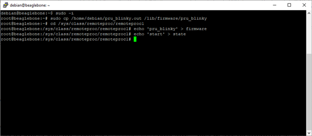

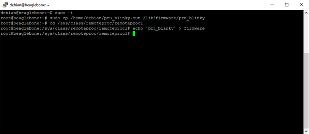

Then we need to deploy it into PRU0 - confusingly referred to a remoteproc1. (PRU1 is remoteproc2. remoteproc0 is to do with the Cortex M3 co-processor.)
cd /sys/class/remoteproc/remoteproc1
echo 'pru_blinky' > firmware
Go!
Are you ready? It's taken us a while to get here but to finally run your cross-compiled C code in the PRU all you need is:
echo 'start' > state

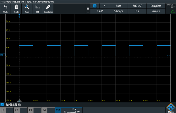

See that big fat nothing that happened? That lack of an error message? That means your code is running! And look - we have a nice clean 1kHz square wave on the output pin. Hooray for square waves! My wife doesn't understand why I'm excited about this, but I'm sure you do.
