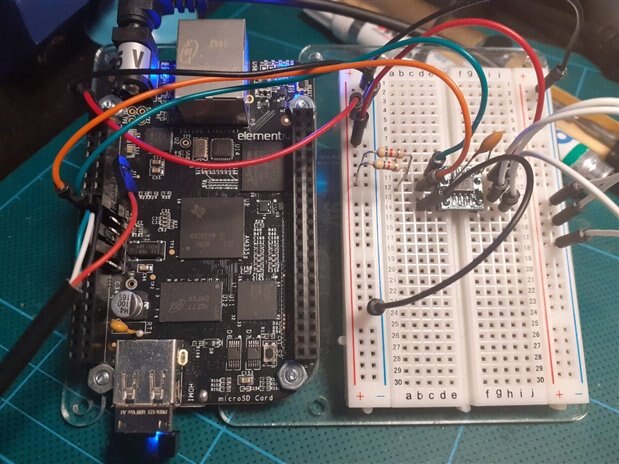

The BeagleBone Black is mounted next to a breadboard to make experiments like these easier.

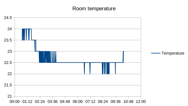

Results
After I let the script run overnight, while taking a break from writing this blog, the resulting CSV-file was imported into LibreOffice Calc. The date format I chose to use is one that can be imported as proper date value in a spreadsheet, with LibreOffice Calc this is done by checking the "Detect Special numbers" box in the Import file dialogue.
The LM75 can only resolve up to half a degree Celsius, making for a very jagged graph.
