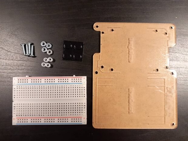

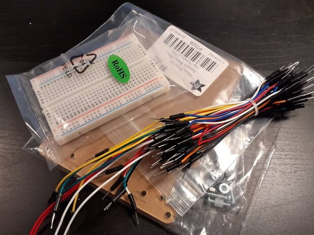

Adafruit kit content
Included with the Adafruit kit is the engraved acrylic baseplate, screws, spacers, nuts and rubber feet.
A matching 400 connection point breadboard is shown which is not included in the kit.

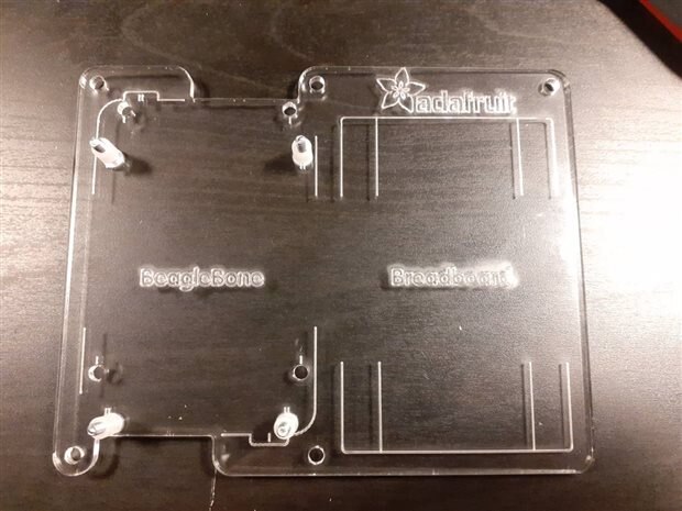

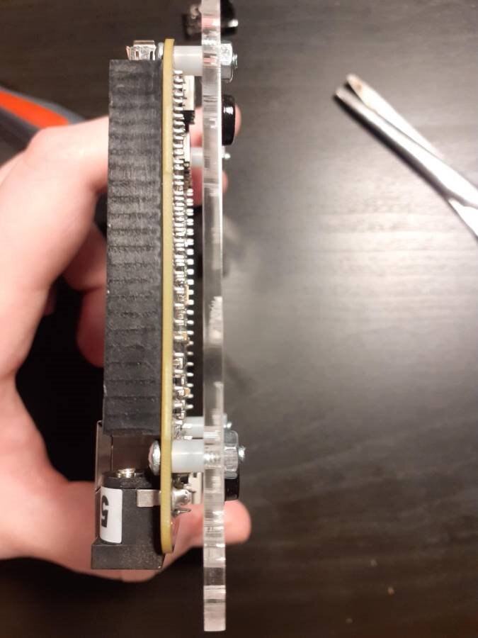

Mounting the BeagleBone
Starting by putting the screws into the acrylic base and laying it flat on the table, mounting the BeagleBone wasn't too fiddly.
All nuts except the one by the DC-jack could be threaded on lightly from the top side.
Tightening it down with a screwdriver and my fingernails seems to be good enough.
It's not possible to mount the BeagleBone with the nuts on the bottom, the screws are longer than the rubber feet.

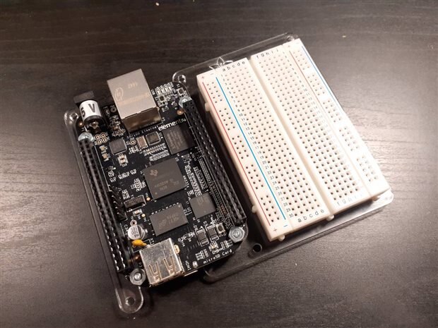

Usage

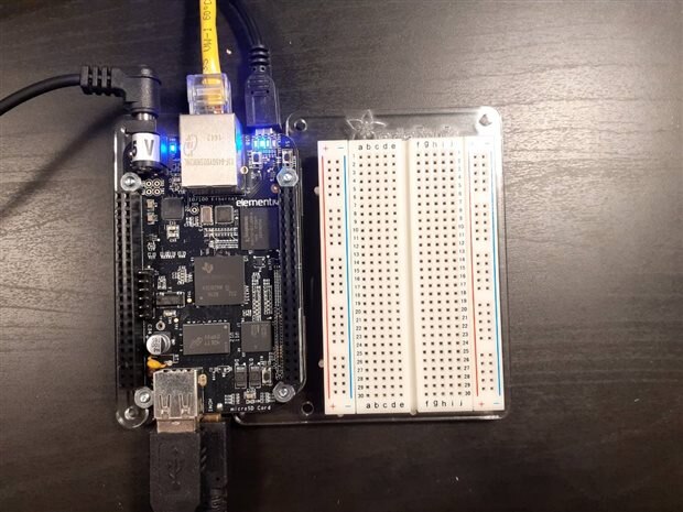

The BeagleBone Black is a full Linux computer and it's therefore likely to have several peripherals connected at the same time. Such as networking, a monitor and a USB-keyboard and mouse. That means easy access to the port and that it's staying in place is important. The intended use of the Proto Plate is making prototyping easier, which is tested by wiring up an external I²C device and taking a temperature reading.
Accessing the connectors
Connecting every possible connector I felt the cutouts in the acrylic base together with the grippy feet made it easy to plug in everything. Even the access to the microSD card was good.

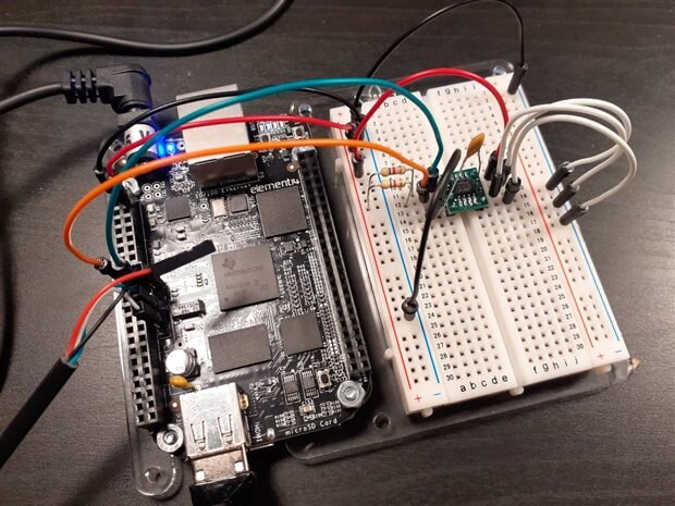

To test if the Proto Plate is pleasant to prototype with a LM75 temperature sensor was connected and read. This is the 741 of digital temperature sensors in that it's not the best you could ever get, but it's been around for so long that some more accurate senors are drop-in replacements for it (plus it's supported in the Linux kernel).
The BeagleBone use 3.3 Volt logic levels and the default GPIO setting makes the I²C-2 bus available on the P9 header (see BeagleBone 101 for more information about this). So I was being very careful when reading the datasheet for the LM75 and making sure all connections are good, twice, before powering it on.

Making sure we're in the i2c group and are allowed to scan the bus and issue read commands. We see that there's an unconfigured device at address 0x48, that's the default address of the LM75 when A0-A2 are grounded, great!

It says it's 24 °C, the trailing zeros are because hwmon devices present temperature in millidegree Celsius. By putting my finger on the LM75 I see that the temperature reading is higher and that the sensor is indeed working.
