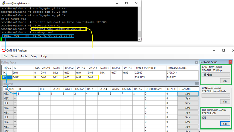

sudo config-pin p9.24 can
sudo config-pin p9.26 can
2. Enable the Linux interface
CAN is implemented as a network in Linux. You use similar utilities as when defining a TCP/IP network.
sudo ip link set can1 up type can bitrate 125000
sudo ifconfig can1 up
Again, Thomas' instructions describe a way to do this permanently.
3. Send and Receive Data
The BeagleBone has Linux CAN utilities installed by default these days.
These can be used to try out the CAN network from the BB side. Both for sending and receiving traffic.
You'll need to have something on the bus to play the other role. In this case I used the Microchip analyser. An Arduino MKR with a MKR CAN shield and example sketches works equally well.
cansend can1 5A1#00.01.02.03.04
candump can1

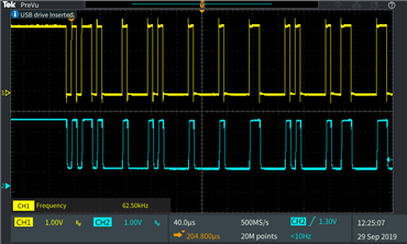

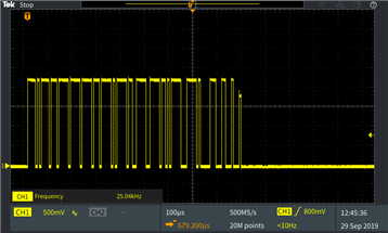

The Logic and Physical Layer Signals

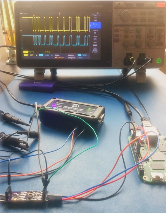

While doing this exercise, I captured some data on both sides of the BB driver.
The logic level has TX and RX signals separate. Both 3.3V logic signals. The physical layer is differential.
CAN data: logic layer - Tx and Rx lineCAN data: physical layer - differential CAN signal

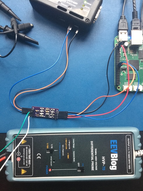

I probed the HI and LO with a differential probe.
