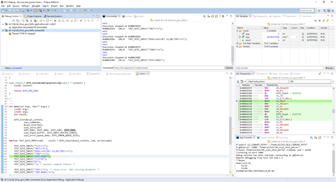

I have a DS-5 IDE running on my Windows 10 PC, and I'm able to cross-compile Linux applications for the BeagleBone.
I've never been able to get the debugger working though. I'd like to attach to my cross-compiled program that's executing on the BBB, and step trough it.
Who's got that working, and how?

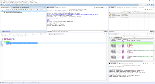

    Ok I just created a helloworld test in DS-5 and I have the debugging working too image so I will try and document the steps required.

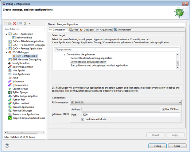

    ok Assuming you have toolchain and project configured and that you can create a working executable then here's a brief list of steps I took.
    First create a RSE connection:
         Select Window -> Perspective -> Open Perspective -> Other -> Remote System Explorer
    In the Remote Systems panel select the icon for Define a connection for a remote system
    A window should open listing various connection types, select SSH Only and then Next>
         In the Host Name I entered the Beaglebone IP address and then BBE SSH in the Connection Name then select Finish
    Next I created a debug configuration:
         Select Window -> Perspective -> Open Perspective -> Other -> DS-5 Debug
         Select Run -> Debug Configurations...
    You should get a window open like this:
    On the left select DS-5 Debugger and then the icon to create a new configuration as shown above.
    Under Select target  select Linux Application Debug  > Application Debug > Connect via gdbserver > Download and debug application   as shown above
    Under RSE connection select the one created earlier.
    Select the Files tab then:
         For Application on host to download I select Workspace and navigate to the Debug executable that is produced when I build the project.
         For Target download directory and also Target working directory I used /home/debian/workspace   This is where I chose to put the executable on the Beaglebone.
    I then just clicked on Debug
    First run there's a few popups that I accept and  the  SSH username and password (you can save both if you wish) and thats it the debugger opens and I can single step etc etc.
    Hope that gets you going but if you get any errors let me know.
