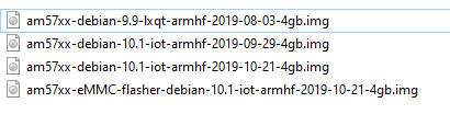

I'm trying to boot Beaglebone AI from SD with the latest image, but all the time getting this:
What I'm doing wrong?
  • clem57
    clem57 over 7 years ago +2 suggested
    Either a bad SD card or a bad image. chkvsk What software did you use to build the image with?

    Make sure you are using the BB AI image (not the BB Black image).  The BB AI image file name starts with am57xx
    (use the link that Sean gave)

  • chkvsk
    0 chkvsk over 7 years ago in reply to clem57
    I have about a dozen Beaglebone Black and Green. Had no issues updating firmware on BB and BBG. Every time using same brand 4GB SD cards something like this: microSDmicroSD
    First time I had this issue when I was trying to update firmware on X15. Debian 8 updating was working fine, but Debian 9 updates - no success.
    Same issue I have with AI.
  • chkvsk
    0 chkvsk over 7 years ago in reply to mp2100
    I've tried this:
    On Beaglebone Black and Green I have no issues with firmware updates.
  • chkvsk
    0 chkvsk over 7 years ago in reply to jissdeodates
    Ok, tried am57xx-debian-9.11-iot-armhf-2019-11-02-4gb.img.xz.
    No luck so far...

  • chkvsk
    0 chkvsk over 7 years ago in reply to crisdeodates
    I've tried maybe 5 different (iot and lxqt) Images with no success. As I mentioned above, had no issues with flashing BBBs and BBGs before and now.
  • Sean_Miller
    0 Sean_Miller over 7 years ago in reply to chkvsk
    Did you ever boot and use it from the flash storage without the card installed?
    Here's a post that describes /dev/mmcblk…:
    https://devtalk.nvidia.com/default/topic/1022062/jetson-tx1/is-there-any-information-about-dev-mmcblk1p1-and-mmcblk0p1-/
    If you didn't boot into flash and make any tweaks, my only thought left would be to be absolutely sure the card is seated.  After try that, I'd have to assume there's a pin broken in the SD slot.
