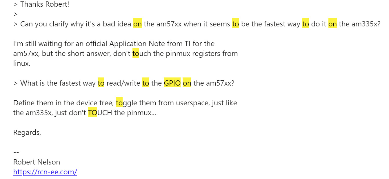

    I think this may be quite hard, I took a look at the robotics cape schematic and pretty much every pin is being used. It's a shame, because had (say) solely SPI been used for the cape, then it would have been a quick thing to directly use the code from BBB to BBB-AI. I've tried to write an I/O library for BB-AI in C, but it's stalled a bit, it's not easy : ( Basically, a direct port of controlling I/O from C from BBB to BB-AI won't work, the register changes are sufficiently different.
    There's bits of info on the beagleboard forum:
    Long story short, for what would have been a high-speed way of interfacing (by directly controlling registers) it's quite hard, and I don't know of a good library of code for it today, and mine is nowhere near complete : ( There's some excellent information here that could help too from  Sean_Miller I've not had a chance to experiment with this yet, because I'd sadly put all my hopes in doing it by controlling registers initially BeagleBone AI Survival Guide V3.18: PWM, I2C, Analog/Digital Read/Write, Vision AI, Video Text Overlays, Audio, & Hardware
