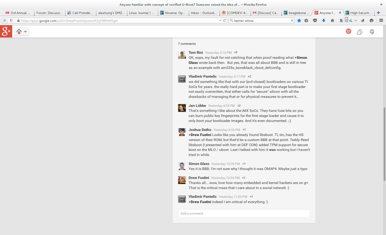

    btw, some interesting discussion from google plus:
    https://plus.google.com/u/0/+DrewFustini/posts/h3yfWfhWGgm
    uboot maintainer Tom Rini commented:
    OK, oops, my fault for not catching that when proof reading what Simon Glass wrote back then.  But yes, that was all about BBB and is still in tree as an example with am335x_boneblack_vboot_defconfig.
    And the author of that LWN article, Simon Glass, commented:
    Yes it is BBB. I'm not sure why I thought it was OMAP4. Maybe just a typo
