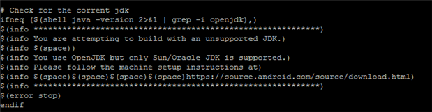

Because we don´t have Oracle JDK6 but OpenJDK6 and the makefile will stop with OpenJDK, we need to change the core makefile.
nano build/core/main.mk
Search for a block like this around line 142.
It´s easy to spot, because it misspells current...
You can either comment/remove that whole block.
Or just comment/remove the line "$(error stop)".
Then save that file and go on.

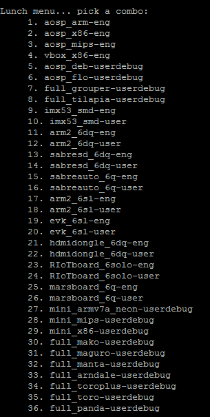

Then call lunch. (Everything in Android has to do with something to eat. Getting hungry here...)
lunch
And you get a list like this.
You see two entries for the RIoTBoard.

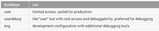

One with -eng and one with -user.
Here´s the explanation for that.
Of course we want -eng. So we type in 23 and press Enter.

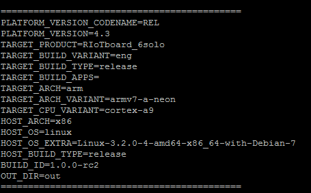

If you´re then greeted with this, you´re ready to compile.
