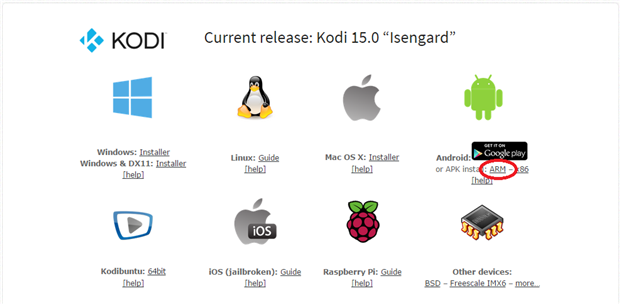

Once within the downloads section, click on the Android – ARM option.
There are two ways to get to the downloaded file. The first is to swipe down from the top-left of the screen. There will be a little down arrow there. This will bring up a list of files that have been down loaded. The other is through the apps menu. In there will be a “Downloads” entry.
When you click on this file, you might get a message saying that the install was blocked. This message will have two options: one to cancel and one to go to the settings page. Click on the settings page. Within the settings page, there should be an option called “Unknown sources”. This will allow programs to be installed that do not come through the Google Play store. Click that check mark. It will then prompt you to make sure that you are certain (which you are).
Changing the settings kicked me out of the installation process, so you might have to find the .apk file again and click on it again.
