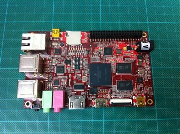

What is it ?
The RIoTboard is an open source community platform, supported by element14 and powered by a Freescale i.MX6 ARM Cortex-A9 processor. The board is meant to help evaluate the various peripherals and includes:
  • 10/100/Gb ethernet port
  • HDMI port
  • LVDS
  • analog audio in/out
  • microSD and SD card interfaces
  • JTAG
  • two camera ports
  • four USB ports
  • two mini USB ports
  • serial debug port
  • expansion port with PWM, SPI, I2C, UART, ...
  • reset button
The Freescale i.MX6 ARM Cortex-A9 processor runs at 1GHz, there is 1GB of DDR memory and 4GB eMMC. Powering the board is done through a 5V DC barrel jack connector.

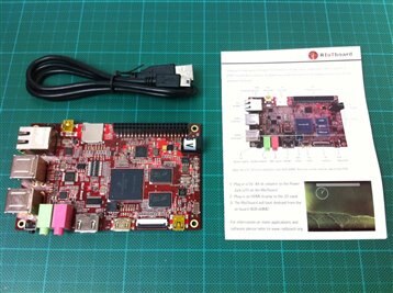

What's in the box ?

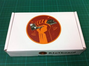

In the box, you'll find the following items:
  • RIoTboard
  • mini-USB cable
  • quick start guide

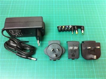

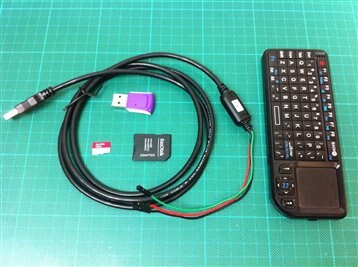

Additionally, you will need following items:
  • HDMI monitor
  • USB keyboard and mouse for input, even if only for initial configuration
  • 5V/4A power supply
And you may need:
  • wifi dongle for wireless connectivity instead of using the ethernet port
  • (micro)SD card (4GB minimum) to use/test an alternative operating system
  • USB UART cable for troubleshooting

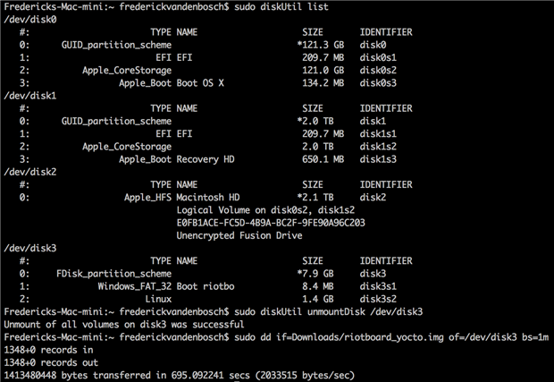

Flashing the SD card
Flashing an image to the SD card is done in the same way as with the Raspberry Pi. So if you are familiar with that, there should be no problems.First, extract the downloaded zip file containing the image, then using "dd" (Linux/OS X) or "Win32DiskImager" (Windows), flash the image on the SD card. The time to flash the SD card may vary depending on its speed, but I've experienced times around 10 minutes using the latest image. It is recommended to use an SD card of at least 4GB, preferably 8GB.

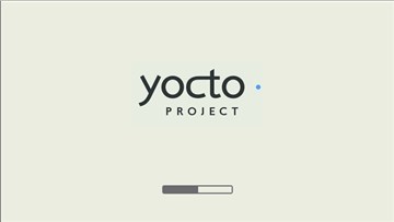

Booting

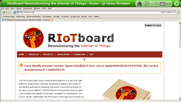

With the SD card inserted and the DIP switch settings adapted, all that remains is to power on the RIoTboard.

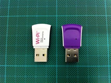

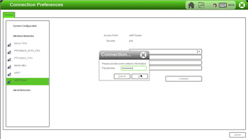

Wireless connectivity
As far as I'm aware, there are currently two officially supported wifi dongles:
  • Wi-Pi wifi dongle
  • element14 wifi dongle (purple)
Both can be obtained from element14 and are compatible with other boards such as the Raspberry Pi or Beaglebone Black.

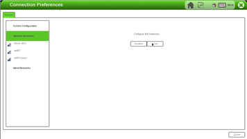

Android
Wireless connectivity works out-of-the-box using the Android 4.4 image (not with 4.3!).

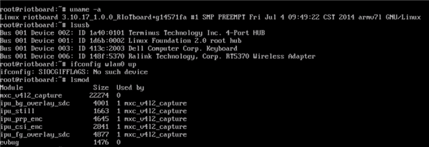

Linux
Using the Yocto image, I was having trouble getting the wifi to work. The wifi dongle was listed using the "lsusb" command, but no "wlan0" interface was available.
After seeking help on the element14 forums in the RIoTboard area, I was given a newer Yocto image (riotboard_yocto_gui_SVN3000) with which wifi worked immediately, just like with the Android 4.4 image. I've been told this newer image will be officially released soon and the issue was related to kernel gadget support not being configured in the previous build.
The new image I received is also more lightweight (1.4GB vs 3.9GB) and boots straight to a graphical environment.

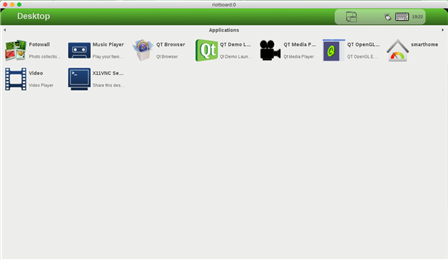

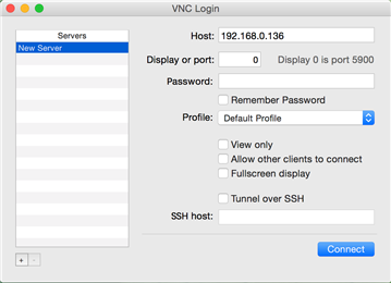

VNC
Using VNC, it is possible to access the desktop remotely.
First the VNC server needs to be started. This can be done via SSH with the following command:
root@riotboard:~# x11vnc -bg -rfbport 5900 -skip_lockkeys -o /tmp/x11vnc.log
Once this is executed, connect to the desktop using a VNC client and IP address of the RIoTboard and port 5900.

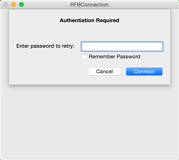

Just like with SSH, there is no password configured by default. This can easily be changed.
root@riotboard:~# x11vnc -storepasswd
Enter VNC password:
Verify password:
Write password to /home/root/.vnc/passwd? [y]/n
Password written to: /home/root/.vnc/passwd
Running VNC with an additional "-usepw" flag will ensure the defined password is required when connecting.
root@riotboard:~# x11vnc -usepw -bg -rfbport 5900 -skip_lockkeys -o /tmp/x11vnc.log

    Are you properly unmounting the SD card before doing the dd command ? Do you have the full output ?
    * sudo diskUtil list
    * sudo diskUtil unmountDisk /dev/sdX
    * sudo dd if=/path/to/image of=/dev/sdX
    Looking at your other thread (Problems flashing new Image (Yocto or Ubuntu)) it seems you have the problem with many more images.
    How are the DIP switches configured on the RIoTboard ?
