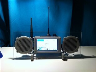

The end of the challenge is nearing, so here's my final post on this project.
I have had a major setback when resuming coding after the build, but I did manage to get a fully functional FM/Internet Radio combo in time.

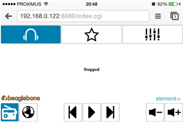

Listening
This video demonstrates the controls to listen to the radio. The controls allow you to switch between FM or Internet radio, start, stop, browse the available channels and set the volume.
You can hear the moment it switches between FM and internet streaming. The audio levels also seem to be different. I'll have to find a way of aligning this.

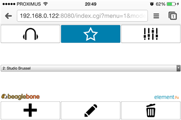

Managing Channels
I developed a simple radio channel management interface which you can view in the video below. It allows you to add new channels and edit or delete existing channels.
The configured channels are stored in a configuration file on disk to make them persistent across reboots.
Managing channels can also be done (more easily) from a smartphone:

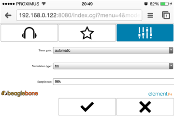

Configuration
Finally, a short video on setting some parameters for the SDR receiver stick. The list could be extended to support a larger set of configurable parameters.
For now, it allows to configure the modulation type, gain and sample rate which are provided to the "rtl_fm" command. Changes are also stored in a configuration file on disk.

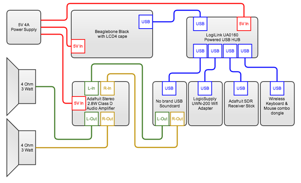

Diagram
I made a simple diagram of the different components involved and how everything is connected.
It's more of an integration project where different existing components are combined into one solution, all glued together with a web application developed in Perl.

As you can see in the picture below, we're having fun with our new radio! Thank you for giving us the opportunity to participate in this Roadtest Challenge.
