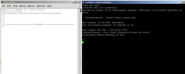

I want to run IDLE but when I do I get an error about the DISPLAY environment variable..
I have heard about being able to run programs using X11 and tunneling with SSH on a host computer.. Does anyone know if this could be done with RIoTboard?? If they have or know if it's possible .......

    e14 Contributor over 12 years ago +1
    the 3.0.35 based distro from from e14 had a password "linaro".
    on the client side you need to add ForwardX11 yes to either /etc/ssh/ssh_config or $HOME/.ssh/config possibly under a Host <ip.of.riot.> section.
    On the RIoTboard you'd need to add something like
    X11Forwarding yes
    X11UseLocalhost yes
    into /etc/ssh/sshd_config
    Then restart sshd to be sure that your changes are noticed.
    In theory you can then ssh into the RIoT and start your X11 app using the CLI.  However there are many other things that might cause issues.. Depending on the distro you might need to relax xauth restrictions or transfer the magic cookie http://www.snapdba.com/2013/02/ssh-x-11-forwarding-and-magic-cookies/ and possibly deal with $DISPLAY.

  • radiatortwo
    radiatortwo over 12 years ago in reply to mubase
    Putty is a client that connects over the SSH protocol to the unix systems console.
    It´s like a remote access to the terminal.
    So yes the username and password you are asked for are those from the Riotboard.
    The username will be most likely "root", since you didn´t add a new user I suppose.
    If you don´t know the password for a user you can change it on the serial console on the Riotboard for example with:
    passwd root
    (As root is the username)
    Then you can login with putty with username root and the password you´be given.

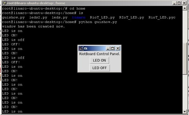

    Found a very nice beginners example of what can be done with Riotboard, Python & GPIOs here...
    its all in Chinese and I wish I understood Chinese but the first program sets up a module to access the USER_LED and a second program controls the LED state  on a screen button press. image

    mubase over 12 years ago in reply to Problemchild
    Hi John Thanks for the info. . I've got Xwindows working. Its fantastic! A board running in tandem with my laptop and I have run some of the example X11 applications like the roving eyes an XMore but the most important for me at the moment is the IDLE python editor which I can now run. imageimage
    The link to the site mentioned above gives an example of what can be done with the Python TKinter library and the Riotboard LEDs.
    I've got it running.
    I've included a screenshot of the putty window & the X11 TKinter control panel
