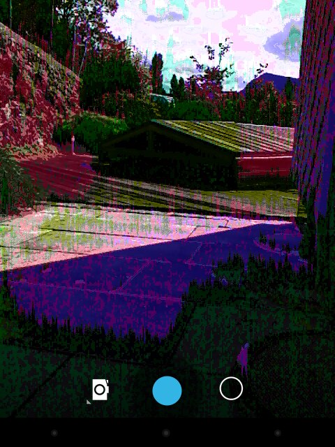

  • McuOnEclipse
    0 McuOnEclipse over 12 years ago in reply to tusharp
    Hello,
    I have ordered the CAM8100-U module, and I can confirm that the module is automatically detected and supported by the RIoT board. However, the images/pictures from this module are having a lot of artifacts and are of bad quality (see attached).
    Anyone else using that camera mdule with the RIoT board?
    Erichimage
  • tusharp
    0 tusharp over 12 years ago in reply to McuOnEclipse
    I have taken pics  in daylight as well as evening, never saw anything like this .
    some improper  post processing is causing this.
  • tusharp
    0 tusharp over 12 years ago in reply to tusharp
    android has some good post processing stuff.
    let me know if you are using any specific apks with camera or specific scenarios which causes this, so that  i can emulate  the same here.
  • McuOnEclipse
    I have used the default RIoT board Android Image/apks, and have not made any modifications.
    More pictures and details in
    http://mcuoneclipse.com/2014/08/16/review-of-the-cam8100-u-usb-camera-module-with-the-riot-board/
    I was first thinking that the connector might cause problems. Checked everything carefully, and this did not improve anything.
    Erich
  • tusharp
       doesn't seem like a connector problem.
      shared this issue with android team. will update once fixed.
