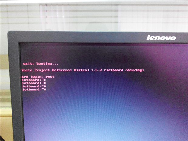

I have loaded the Linux image SVN2652 on Riotboard, but it only boots if HDMI is not connected.
If I connect the HDMI after Linux starts running it also freezes.
    The HDMI screen freezes or Riotboard booting ??
    The HDMI GUI support is not yet enabled in kernel.
    on display devices it will show a terminal with Yocto signature as shown below.

    0 e14 Contributor over 12 years ago in reply to tusharp
    Hi,
    Just to clarify, I don't want a GUI, my application uses GStreamer to output straight to the framebuffer.
    I have tried both the downloaded file and also one that I build with Yocto (fsl-image-fb),  with the same result.
    If I have the HDMI cable connected the kernel would not start. Here is the console output:

    If I have the cable initially disconnected it works OK. As soon as I connect the cable Linux freezes. No serial console and the LED stops blinking.
    The strange thing is that I have a board that works with no problems at all and another four that behave like I described.
    I currently don't have the working board with me to see if there is a hardware difference (however unlikely that is). I should get it back next week.
    The software is exactly the same on all.
