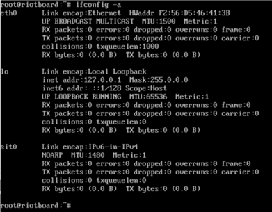

    Having trouble getting the wifi to work with the Yocto Linux image.
  • tusharp
    tusharp over 11 years ago in reply to fvan
    which yocto release you are using ??
    Plz share the output of below command
    ifconfig -a

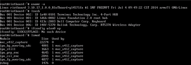

  • fvan
    fvan over 11 years ago in reply to tusharp
    Linux 3.10.17 [RIoTboard SDCard image] (SDcard-image_SVN2652.zip)
    In combination with the purple element14 wifi dongle wifi dongle
  • fvan
    fvan over 11 years ago in reply to fvan
    I would also add that using the Android Kit Kat 4.4 SD Card image (SDcard-image_SVN2705.zip), everything is fine and Wifi works properly.
    That seems to work. Could you explain why it didn't work before (while it does in the videos) and it does with this new image?
    This new image also seems to be smaller in size: 1.41GB vs 3.97GB for the other Yocto image ?
  • tusharp
    Previous build were not configured in terms of kernel GADGET support .
    This build will be the official & the most updated one. Will push this to download center shortly.
