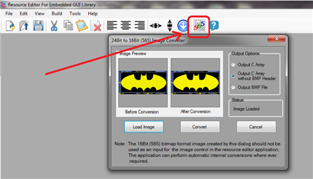

    First download Embedded Resource Editor GUI from www.st.com, it will allow you to convert BMP, jpg and other to char array, and it will generate code.image
    Next you have to have paint bmp function, (you must know converted picture dimensions, like 320x240,  (you must resize jpg or any other file so it can fit inside screen !!!!)
    After that, copy generated file to bmp.h, include that to main.c, and call paint function from LCD library
