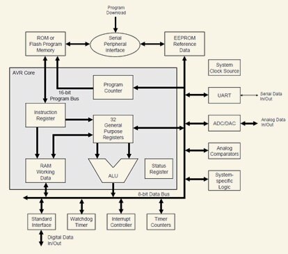

AVR Architecture
AVR Architectureimage
The AVRRegistered Embedded RISC Microcontroller Core is a low-power CMOS 8-bit microprocessor based on the AVR RISC architecture. By executing powerful instructions in a single clock cycle, it achieves throughputs approaching 1 MIPS per MHz allowing the system designer to optimize power consumption versus processing speed.
The AVR Core is based on an enhanced RISC architecture that combines a rich instruction set with the 32 general purpose working registers. Each of the 32 registers is directly connected to the Arithmetic Logic Unit (ALU), allowing two independent registers to be accessed in one single instruction executed in one clock cycle. The resulting architecture is more code efficient while achieving throughputs up to ten times faster than conventional CISC microcontrollers. The architecture supports high level languages efficiently as well as extremely dense assembler code programs. It also provides any number of external and internal interrupts.
The AVR Core is provided in an encrypted netlist format with Verilog and VHDL simulation models, a fully functional test bench and ATPG vectors for >99% fault coverage. It is supported with a full suite of program and system development tools including: macro assemblers, ANSI C Compilers, program debugger/simulators, and in-circuit emulator.

Enhancing Access with Working Registers
Usually, when the CPU executes a program, it requires frequent access to a limited set of data, including pointers, loop counters, semaphore status bits, and array indexes. In fact, close inspection of source code will reveal that most of the data is only required for a very short amount of time, then later discarded. That is why the AVR CPU contains multiple "working registers," which store dynamic data inside the CPU. Organized in a "register file," they eliminate the need to move temporary data from CPU to SRAM—only to read it back a few cycles later. The register file is extremely fast, allowing the CPU to read, execute, and store the result back into a register in a single clock cycle. They also require far less energy when accessed, compared to accessing a large SRAM with long address and data lines. Because no cycles are wasted, power consumption for executing code is greatly reduced.
