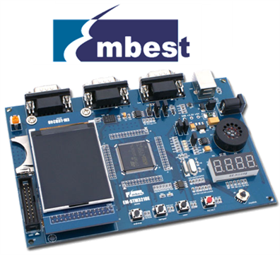

Kit Overview
The Embest's EM-STM3210EEM-STM3210E is an ARM embedded evaluation board produced by Embest, integrate the STMicroelectronic ARM Cortex-M3 core-based processor STM32F103ZESTM32F103ZE, operating at a 72 MHz frequency. The board features USB, CAN, SD Card interface, TFT-LCD, RS232 serial interface, four 26-pin user extended interface, etc. Plenty of software examples, which can be used in Keil MDK environment, are provided in the CDROM.
The STM32F103 Performance Line family incorporates the high-performance ARM Cortex-M3 32-bit RISC core operating at a 72 MHz frequency, high-speed embedded memories (Flash memory up to 128Kbytes and SRAM up to 20 Kbytes), and an extensive range of enhanced I/Os and peripherals connected to two APB buses. All devices offer two 12-bit ADCs, three general purpose timers with PWM outputs, as well as standard and advanced communication interfaces: up to two I2Cs and SPIs, three USARTs, an USB and a CAN.
The ARM Cortex-M3 processor is the latest generation of ARM processors for embedded systems. It has been developed to provide a low-cost platform that meets the needs of MCU implementation, with a reduced pin count and low-power consumption, while delivering outstanding computational performance and an advanced system response to interrupts.
Key Applications: STM32F103 Performance Line microcontroller family suitable for a wide range of applications such as Motor drive and application control, Medical and handheld equipment, PC peripherals and medical monitors, Industrial applications: PLC, inverters, printers, and scanners, Alarm systems, Video intercom, and HVAC

Kit Features
  • Processor:STM32F103ZESTM32F103ZE,Frequency:72MHz
  • Internal memory: 512KB Flash, 64KB SRAM.
  • External memory: 128KB SRAM, 8M byte SPI Flash, 2MB NOR FLASH, 128MB NAND FLASH
  • uCOS-II v2.86 ported
  • 8M byte SPI Flash
  • RTC(Including back-up battery)
  • Start jumper settings
  • Optional two-way power:5VDC and USB
  • An SD memory card interface
  • TFT-LCD interface
  • A temperature sensor
  • An audio DAC output
  • 20Pin JTAG debug interface
  • Two RS232 serial port
  • A USB Device interface
  • A rocker handle with four functions to control the direction
  • Four keys with functions: Reset, Wakeup, Temper and User button four Led lights
  • Four LED lighter
  • Four 8-LED output
  • A CAN bus interface which lead by the DB9 interface
  • A AD input
  • Four user’s interface with 26Pin
  • Source code of example program
