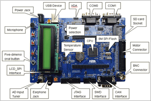

The Embest's STVL (STM32F103V100) Starter Kit is the low cost development kit for STMicroelectronic's STM32F103VBT6STM32F103VBT6 (72MHz, the very popular ARM Cortex-M3 processor), including the STM32F103V100 evaluation board and Emlink for ARM JTAG adapter, so the developers can easy start to learn and test all the relevant applications on it, or evaluate your new project design through this entire system.
The STM103V100 is an arm evaluation board for STMicroelectronic's ARM Cortex-M3 core-based STM32F103VBT6STM32F103VBT6 microcontroller for evaluating or prototyping platform based on the STM32F10x microcontrollers. The device has a complete range of peripherals including full speed USB2.0, CAN2.0A/B compliant interface, two I2C channels, two SPI channels, three USART channels with smartcard support, internal 20KB SRAM and 128KB Flash, JTAG, SWD and uLinkMe debugging, motor control connector, SD card socket, etc. The arm evaluation board is provided with plenty of software examples, which can be used in popular Keil MDK environment.
The STM32F103V100 Starter Kit contains all the necessary hardware and software and allows you to design, develop, integrate and test your applications:
  •     ST STM32F103V100 ARMCortex-M3 Board
  • Keil MDK-ARM Development Kit, 32K evaluation edition
  •     Emlink for ARM - a high speed JTAG Emulator for ARM Cortex-M3 processors
  •     Plenty of example programs, all in source code
The ARM Cortex-M3 processor is the latest generation of ARM processors for embedded systems. It has been developed to provide a low-cost platform that meets the needs of MCU implementation, with a reduced pin count and low-power consumption, while delivering outstanding computational performance and an advanced system response to interrupts. The ARM Cortex-M3 32-bit RISC processor features exceptional code-efficiency, delivering the high-performance expected from an ARM core in the memory size usually associated with 8- and 16-bit devices.
Key Applications: Motor drive and application control, Medical and handheld equipment, PC peripherals, Medical monitors, Industrial applications: PLC, inverters, printers, and scanners, Alarm systems, Video intercom, HVAC.

  • ST STM32F103V100 ARM Cortex-M3 Board:
    • Processor: STM32F103VBT6STM32F103VBT6cortex-m3, 72MHz, compatible with STM32F103V8T6STM32F103V8T6 (100 pins), STM32F103RBT6STM32F103RBT6, STM32F103R8T6STM32F103R8T6, STM32F103C8T6, STM32F103C6T6STM32F103C6T6
    • 8Mbyte serial Flash
    • RTC with backup battery
    • Three Power supply options: 5V DC power supply, USB power supply, led out Pin strip
    • One USB device (USB2.0)
    • One CAN2.0 interface
    • Two RS232 serial ports (one supports RTS/CTS function)
    • IrDA transceiver
    • LCD interface with 16x2 Character LCD
    • SD card socket
    • Smart card socket (on the rear of the board)
    • One Motor control connector
    • One extended temperature sensor
    • Audio play/record
    • Two debug interfaces options: 10-pin SWD or 20-pin JTAG
    • Four buttons (Wakeup, Reset, Tamper and User)
    • Four LEDs
    • Joystick with 4-direction control and selector
    • Dimensions: 172mm x 114mm
