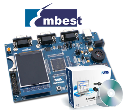

The Embest's STM3210E-SKSTM3210E-SK is the low cost development kit for STM32F103ZESTM32F103ZE (72MHz, the very popular ARM Cortex-M3 processor), including the STM32F103ZEH6STM32F103ZEH6 evaluation board (STM3210E Board) and Emlink for ARM JTAG adapter, so the developers can easy start to learn and test all the relevant applications on it, or evaluate your new project design through this entire system.
The STM3210E-SKSTM3210E-SK Starter Kit contains all the necessary hardware and software and allows you to design, develop, integrate and test your applications:
  • ST STM3210E-SK/KEILSTM3210E-SK/KEIL ARMCortex-M3 Board
  • Keil MDK-ARM Development Kit, 32K evaluation edition
  • Emlink for ARM - a high speed JTAG Emulator for ARM Cortex-M3 processors
  • Plenty of example programs, all in source code (These software examples can be debugged under the popular Keil MDK (Microcontroller Development Kit) environments, making practical use of the board's peripherals.)
  The STMSTM32F103ZESTM32F103ZE is an ARM embedded evaluation board produced by Embest, integrate the STMicroelectronic ARM Cortex-M3 core-based processor STM32F103ZEH6STM32F103ZEH6, operating at a 72 MHz frequency. The board features USB, CAN, SD Card interface, TFT-LCD, RS232 serial interface, four 26-pin user extended interface, etc.

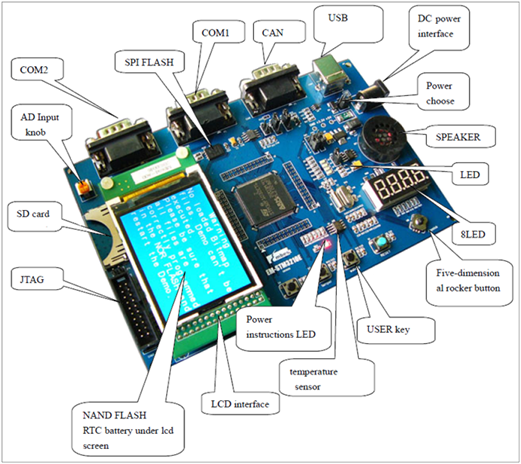

Kit Features
The ST STM3210E-SK/KEILSTM3210E-SK/KEIL ARM Cortex-M3 Board:
  • Includes one 2.4" TFT LCD
  • STM32F103ZESTM32F103ZE, ARM Cortex-M3 based, 72MHz
  • 512KB Flash memory and 64KB SRAM
  • XTAL Frequency: 8 MHz
  • Two RS232 Interface
  • One CAN interface
  • One USB Device Interface
  • One TFT LCD interface
  • One MicroSD Card interface
  • One 20pins JTAG Interface
  • Four Push Buttons (Reset, Wake Up, Tampering, User)
  • One Joystick with 4-direction control and selector
  • One RTC Unit with backup Battery
  • One Temperature Sensor
  • One Analog Input (connected to potentiometer),
  • One Analog Output (connected to speaker by default)
  • Supply Voltage: 5 Volts DC (provided by USB Cable)
  • Board Size: 110mm x 140mm (4.33" x 5.5")
