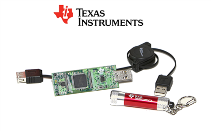

The TMDX470MF066USBTMDX470MF066USB is a USB Kit which can be used to quickly develop code and evaluate performance of the TMS470M MCU. It includes the automotive grade Cortex-M3 ARM CPU based TMS470MF066 microcontroller running at 80MHz, with 640KB of Flash, 64KB of RAM, and a enhanced set of peripheral modules. The TMS470MF0466 is a member of the Texas Instruments TMS470M family of Automotive Grade 16/32-bit reduced instruction set computer (RISC) microcontrollers.
The TMS470M microcontrollers offer high performance utilizing the high efficiency CortexTm-M3 16/32-bit RISC central processing unit (CPU), resulting in a high instruction throughput while maintaining greater code efficiency. The TMS470M devices utilize the big-endian format where the most-significant byte of a word is stored at the lowest numbered byte and the least-significant byte is stored at the highest numbered byte.
The USB Stick includes an integrated XDS100v2 emulator so that no external JTAG emulator is required to get started. The USB Stick also provides access to some of the key peripherals, a CAN Transceiver, and an Ambient Light Sensor (used for demo purposes).The TMS470M USB KitTMS470M USB Kit also includes a complete software development environment with CCStudio v4.1, Halcogen Peripheral Drivers, Flash Programming Utility, HET Simulator/Debugger w/ Synapticad WaveViewer, code examples, and much more.
Key Applications: Electric power steering (EPS), Braking systems (ABS and ESC), Safety-related automotive, Automotive Infrastructure, Commercial Vehicles, Off-road vehicles, Airbags, electric park brake, safe communication, parking assist.
