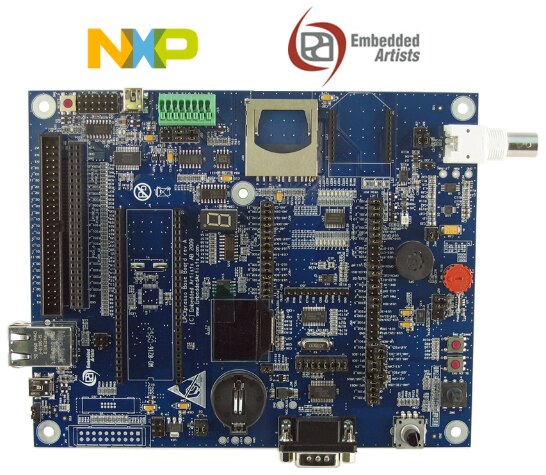

The LPCXpresso Base BoardLPCXpresso Base Board makes it possible for you to get started with experiments and prototyping immediately. It is designed for the LPCXpresso Board (with multiple targets LPC176xLPC176x, LPC1343LPC1343, LPC1227LPC1227, LPC11C24LPC11C24, LPC11U14LPC11U14, LPC1114LPC1114, and more to come) and the mbed module from NXP. Note that the LPCXpresso Base BoardLPCXpresso Base Board is delivered with two pin lists. These pin lists must be soldered onto the LPCXpresso target board before it can be used with the LPCXpresso Base Board. The LPCXpresso Base Board can also be used together with the mbed module. The mbed module already has pin lists, so no special preparation is needed for this module.
The board has been design in cooperation with several Universities in order to also be suitable for training and education situations. The many on-board peripherals easy your learning curve and speed up your program development. Those peripherals include accelerometer, I2C-EEPROM, SPI-Flash, 5-key Joystick, 7-segment Display, Light Sensor, OLED Display (including simple Graphics Library, PCA9532 (LEDs), RGB LED, Rotary Switch, Temperature Sensor, UART2 (I2C/SPI to UART, SC16IS752IPW,112SC16IS752IPW,112).

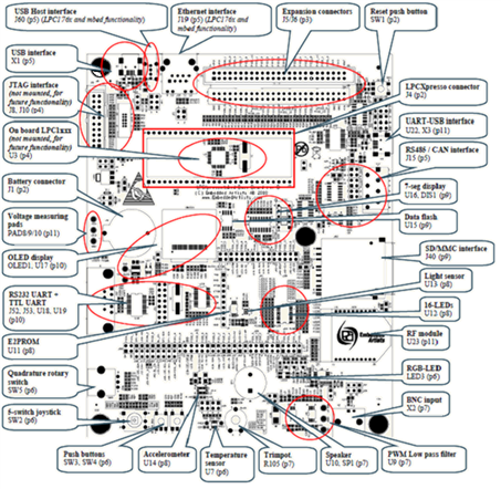

Kit Features
  • Common features
    • Socket for LPCXpresso and mbed module
    • 50 pin expansion dual row pin list connector (male, 100mil pitch) for simple connection external designs and to a logic analyzer
    • 50 pin expansion dual row header connector (female, 100mil pitch) for simple connection to breadboard
    • Battery powering (small coin battery)
    • USB interface
    • Reset pushbutton
  • Digital IO
    • RGB-LED (can be PWM controlled)
    • 5-key joystick switch
    • 2 pushbuttons, one for activating target mcu on-chip bootloader
    • Rotary switch with quadrature encoding (timer capture)
    • Temperature sensor with PWM output (timer capture)
  • Analog IO
    • Trimming potentiometer input (analog input)
    • PWM to analog LP-filtering (PWM output and analog input)
    • Speaker output (PWM output)
    • Oscilloscope probe inout stage
  • Serial bus - SPI
    • Shift register driving 7-segment LED
    • SD/MMC memory card interface
    • Dataflash SPI-NOR flash
  • Serial bus - I2C
    • PCA9532PCA9532 port expander connected to 16 LEDs
    • 8kbit E2PROM
    • MMA7455LMMA7455L accelerometer with I2C interface
    • Light sensor
  • Serial bus - I2C/SPI shared
    • SC16IS752IPW,112SC16IS752IPW,112 - I2C/SPI to 2xUART bridge; connected to RS232 full-modem interface and one expansion UART
    • 96x64 pixel white OLED (alternative I2C/SPI interface)
  • Serial bus - UART
    • USB-to-serial bridge, with functionality for automatic ISP activation (note: no such support for LPC176x and mbed)
    • RS422/485 interface
    • Interface socket for XBee RF-module
  • Specific mbed module support
    • CAN bus interface (can be simulated with LPCXpresso)
    • Ethernet RJ45 connector with integrated magnetic
  • Dimensions
    • 150 x 180 mm
  • Power
    • Powered via USB (+5V)
