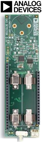

Analog Devices: CN0234 Reference Design for Single Supply, Micropower Toxic Gas Detector Using an Electrochemical Sensor
Kit Overview
The EVAL-CN0234-SDPZEVAL-CN0234-SDPZ circuit  is a single-supply, low power battery operated, portable gas detector using an electrochemical sensor. Electrochemical sensors offer several advantages for instruments that detect or measure the concentration of many toxic gases. Most sensors are gas specific and have usable resolutions under one part per million (ppm) of gas concentration. They operate with very small amounts of current, making them well-suited for portable, battery powered instruments.
The circuit  uses the ADA4505-2, dual micro-power amplifier, which has a maximum input bias current of 2 pA at room temperature and consumes only 10 μA per amplifier. In addition, the ADR291ADR291 precision, low noise, micropower reference consumes only 12 μA and establishes the 2.5 V common-mode pseudo-ground reference voltage.
The ADP2503ADP2503 high efficiency, buck-boost regulator allows single-supply operation from two AAA batteries and consumes only 38 μA when operating in power-save mode.
Total power consumption for the circuit (excluding the AD7798AD7798 ADC) is approximately 110 μA under normal conditions (no gas detected) and 460 μA under worst-case conditions (2000 ppm CO detected). The AD7798 consumes approximately 180 μA when operational (G = 1, buffered mode) and only 1 μA in the power-save mode.
This circuit uses the EVAL-CN0234-SDPZEVAL-CN0234-SDPZ circuit evaluation board and the EVAL-SDP-CB1ZEVAL-SDP-CB1Z system demonstration platform (SDP-B) evaluation board. In addition, a small adapter board included with the EVAL-CN0234-SDPZ is required to connect the two circuit boards together. The EVAL-CN0234-SDPZ includes an AD7798 16-bit Σ-Δ ADC to digitize the output voltage of the circuit.

Kit Contents
The Analog Devices EVAL-CN0234-SDPZEVAL-CN0234-SDPZ kit is supplied with below contents:
  • Evaluation Board
