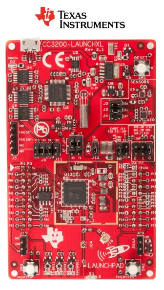

Overview
Start your design with the industry’s first single-chip programmable microcontroller with built-in Wi-Fi connectivity. The CC3200 Launchpad (CC3200-LAUNCHXLCC3200-LAUNCHXL) kit is a development platform created for the Internet of Things (IoT), the SimpleLinkTm CC3200 device is a wireless MCU that integrates a high-performance ARMRegistered CortexTm-M4 MCU allowing customers to develop an entire application with a single IC. The board features on-board emulation using FTDI device and has temperature sensors and a 3-axis accelerometer for a full out of the box experience.
Traditional Wi-Fi solutions are designed for powerful microprocessors. CC3200 undertakes nearly all the functions required for Wi-Fi and networking thereby taking the strain off the host processor.  With a Wi-Fi network processor containing on-chip WLAN and TCP/IP stack, as well as the SimpleLink connection manager, Embedded Crypto engine with 256-bit encryption, WPA personal and enterprise security, the CC3100 and 3200 make Wi-Fi design easy.
The CC3200 LaunchPad comes with driver support and SimpleLink Wi-Fi software SDK with 40+ applications for Wi-Fi protocols, internet applications and MCU peripheral examples and documentation needed to use the SDK. It also contains the Flash Programmer, a Command Line Tool for flashing SW, Configuring Network and Software parameters (SSID, Access Point Channel, Network Profile etc), System and User Files (Certificates, Web pages etc). All the user guides, design files, peripheral, API guides are also available.

Kit Features
  • CC3200 WIFI application processor
  • USB interface to PC for CCS/IAR using FTDI  USB drivers
  • Flash update over the USB using Simple Link Programmer
  • 2x20 pin Connectors: Compatible to TI MCU Launch Pads with added functions
  • Standalone development platform featuring temperature sensors, accelerometer , LEDs and push-buttons
  • Power from USB for the launchpad as well as  external boosterpack
  • Operates from 2xAA alkaline batteries
  • Push buttons for RESET
  • 3 user LEDs
  • On-board antenna and U.FL connector selectable using a capacitor re-work
  • Supports 4 wire JTAG and 2 Wire SWD
  • Sensors including temperature and 3-axis accelerometer
  • BoosterPack headers
  • GDB (GNU Debugger) support over OpenOCD

    TI should have added a simple switch on this launchpad  to toggle between programming mode and execution mode instead of forcing us to use the jumper. Its a pain.
    Also by seeing the 40 pins available on this, i thought this board would be equivalent to Tiva C series launchpad  + wifi chip (cc3200).. But not so fast. This doesn't have all the peripherals like the Tiva C and a bunch of weirdness on the ADC.
    Having said that its a nice board to check out the WiFi capabilities of the CC3200..
