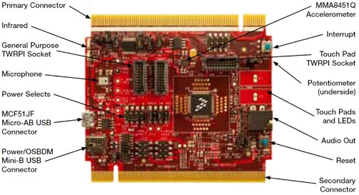

The TWR-MCF51JF tower module is part of the Freescale Tower System (TWR-MCF51JF-KIT ), a modular development platform that enables rapid prototyping and tool re-use through reconfigurable hardware. Take your design to the next level and begin constructing your Tower System today. The TWR-MCF51JF tower system can operate as a standalone debug tool and can be purchased separately as a kit, part number TWR-MCF51JF-KIT , including the TWR-MCF51JF module, TWR-PROTO and TWR-ELEV .
TheTWR-MCF51JF tower module can function as a stand-alone, low-cost platform for the evaluation of the ColdFire+ MCF51JU and MCF51JF microcontroller (MCU) devices. The TWR-MCF51JF features the MCF51JF, a ColdFire+ 32-bit microcontroller built on the Version 1 (V1) ColdFireRegistered core and enabled by innovative 90nm thin film storage (TFS) flash process technology with FlexMemory. The MCF51Jx families offer a rich combination of additive peripherals including USB, hardware encryption, an innovative touch sensing interface (TSI), and more.
The TWR-MCF51JF is available as a stand-alone product or as a kit (TWR-MCF51JF-KIT )) with the Tower Elevator Modules (TWR-ELEV ) and the Tower Prototyping Module (TWR-PROTO ). The TWR-MCF51JFcan also be combined with other Freescale Tower peripheral modules to create development platforms for a wide variety of applications.

Kit Features
  • Tower compatible microcontroller module
  • MCF51JF128VLH: MCF51JF with 128 Kbytes of flash in a 64 pin LQFP package
  • Dual role USB interface with Micro-AB USB connector
  • Touch Tower Plug-in Socket
  • General purpose Tower Plug-in (TWRPI) socket
  • On-board debug circuit (OSBDM) with virtual serial port
  • Three axis accelerometer MMA8451Q
  • Two (2) user-controllable LEDs
  • Two (2) capacitive touch pads
  • One (1) user pushbutton switch
  • Infrared transmit and receive
  • Potentiometer
  • Microphone (ADC) and audio output (DAC)
