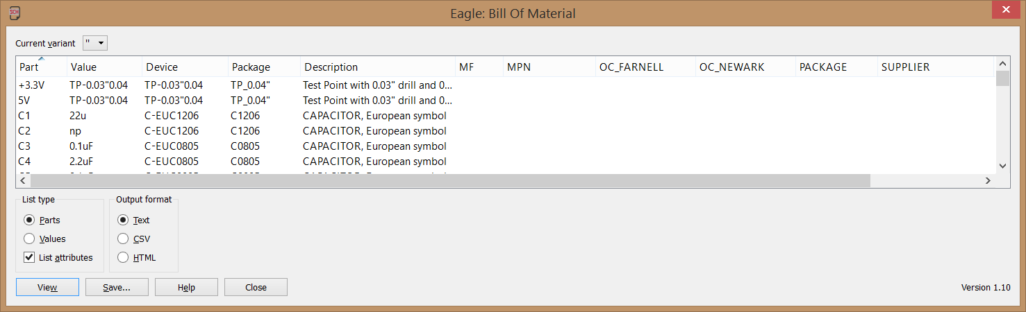

BOM.ULP: Generate a BOM based on component data
EAGLE is capable of maintaining manufacturer and part number for each part so the schematic can be the controlled document for manufacturing information. The BOM.ulp is there to output this data in a format that manufacturing can easily read.
How to Use:
In the schematic editor, click the ‘ULP’ button and select ‘bom.ulp’. Review for accuracy, and then save it in the desired format.

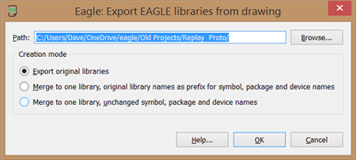

Exp-Lbr.ulp: Build a component library from a design.
As a consultant, I am always careful to keep each client’s design files separate. When a client wants the EAGLE library to be included when I send them documentation it would be inappropriate an unwieldy to give them libraries that may include components designed for other clients. This ULP is great for saving a library to accompany design documentation so another engineer can easily modify a component’s details without having to create it from scratch. I’ve used it before with great success!
How to Use:
This ULP has a nice shortcut found in File>Export>libraries

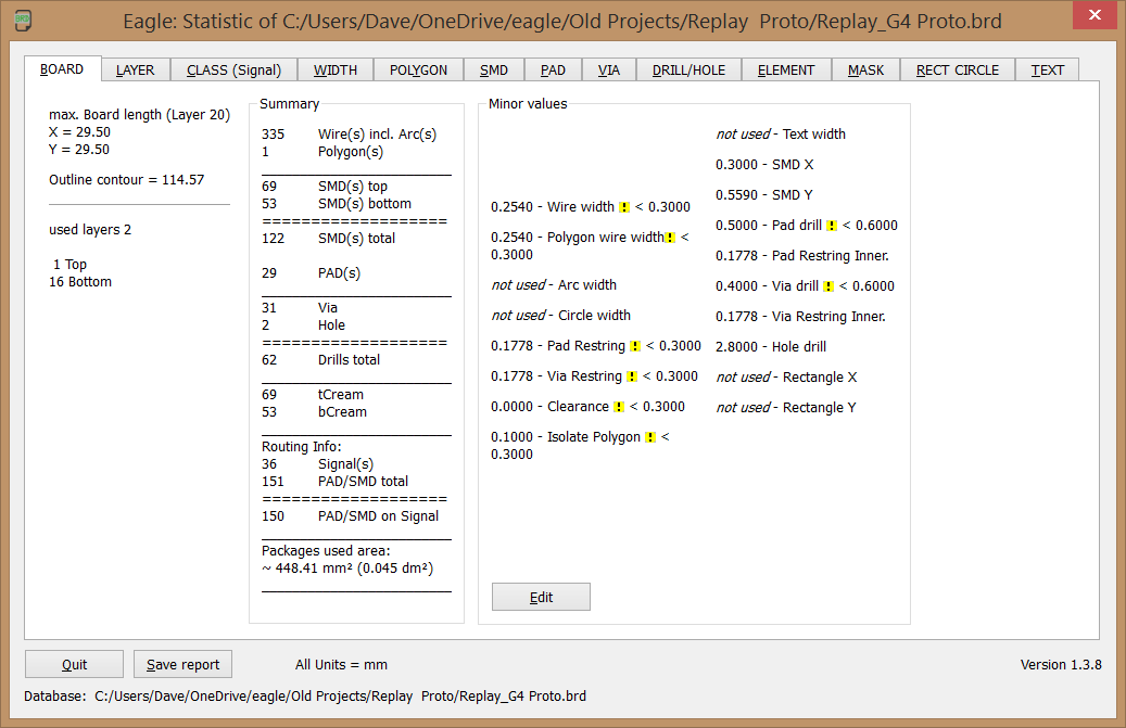

Statistic-brd.ulp:  Details some standard stats about the board.
I’ve added this to my standard PCB review process. It takes about 30 seconds, but going through all of the board stats can have something stick out like a sore thumb. I’ve found myself saying, ‘I don’t remember creating a hole of that size’ or ‘There shouldn’t be a trace that fat in there’ which uncovered an error.
How to Use:
In the layout editor, click the ‘ULP’ button and select Statistic-brd.ulp. Click through the resulting data.
