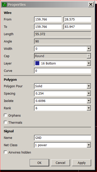

Hi everybody,
I am quite new using Eagle Soft for our PCBs...
I am using polygons for Ground and power planes, but I am not able to change the isolation parameter. Always I have an isolation between the polygons and other objects set as 1.27mm, although I change it in polygon propierties. I also checked the design rules, but with no results.
Could anybody guide me to find a solution? I understand is better for manufacturing to have a generous isolation between polygons and other objects, but for a small PCB, a isolation of 1.27 is to much!
Thanks in advance!
Jordi
    0 e14 Contributor over 10 years ago
    Hi Jordi,  I will provide screen captures of the steps I just used.  Let me know if this helped you.
    Select " i "
    Click on the polygon you want to edit and you should see this screen: (Note: make certain the layer is correct.  In my case, the polygon is on Layer 16.
    Can you get to this point?
    Brian
