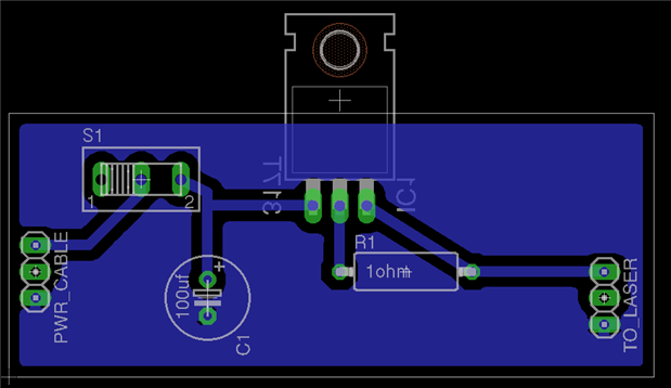

Has anyone here used a laser cutter in conjunction with eagle to make pcbs?

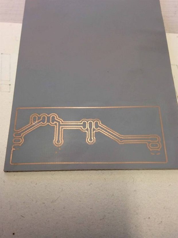

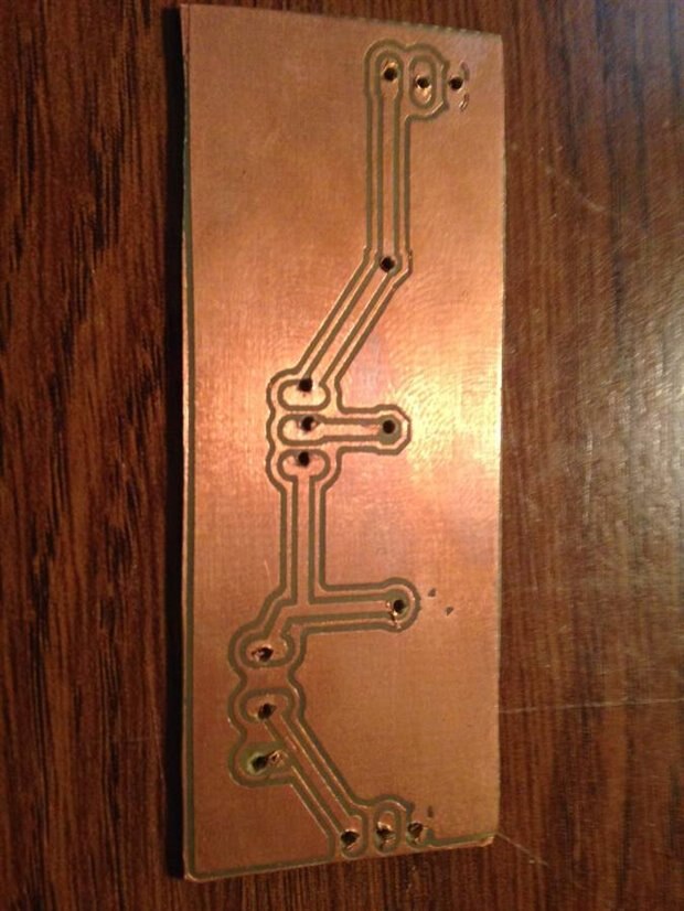

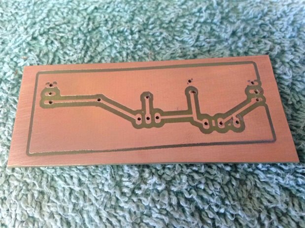

im using pcb-gcode to create the code to use with a milling machine (modding it to turn the laser on and off once it generates the code), then running it through EMC2 that controls our 40w cutter. I spray paint the side of the copper board I intend to use and vaporize the traces with the laser...
im just curious if anyone else has a similar workflow, the only real problem I'm having is spotting/marking the holes so enough copper gets etched away so my hand drilling is a bit more accurate (yes I could completely use a drill press but I don't have one image )
MAybe a modified method that results in bigger holes being marked?
thanks for reading!
