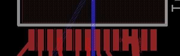

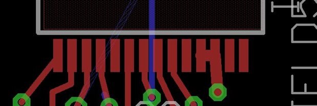

Running DRC Creates 'Ghost' traces.
e14 Contributor
Every time I run DRC I get stray Traces and hundreds of errors.  The ghost traces are on  different layers and cause  Width, clearance,distance, etc errors.  Images of Before and after  running DRC shown below.   Currently using Eagle 7.1 -- Have had problem in previous versions of 6 but seems to be getting worse. I'm running Win8 Pro.  Don't know if it is an OS problem or not.   Images persist on reloading but disappear when I delete the '.pro' file.   Ghost traces don't appear to get imbedded into Gerber files but do create problems running down trace errors. How to I prevent this behavior.

    0 autodeskguest over 11 years ago in reply to e14 Contributor
    On 30/10/14 15:26, G.T. Grey wrote:
    You may be right.  I thought each error was simply highlighted with a
    square box as it was selected in the dialog box.
    No, that's only to draw your attention to it. The real "indication of
    the problem" is drawn hatched in the appropriate colour for the layer
    it's been found on. This allows the DRC to show exactly how big a
    problem you've got with clearance errors, because it only hatches the
    overlap of the required clearances.
    But it that's the
    case,  Why doesn't it disappear when a correction is made and the DRC is
    re-run??
    Simply adjusting the position of your tracks doesn't clear the DRC
    error. You have to explicitly tell Eagle that you (think you) have fixed
    it, by clicking the "Processed" button on the DRC dialogue. (Older
    versions of Eagle had a "delete" button instead, which was more obvious
    in what it did).
    Why do these 'ghost' traces remain on the board layout after
    the DRC dialog is closed ??
    Because the errors are still there, unless you've cleared them.
    And.. if cleared in the dialog box, they
    never show up again unless the .pro file is deleted and the board is
    reloaded.
    How are you clearing them? Since Eagle 5 it's been possible to "Approve"
    errors. This was added because sometimes you need to do things that are
    actually fine but always create DRC errors (search for threads on
    connecting two nets together to see an example). What approve does is to
    mark that error as one you know about, are sure is actually fine, and
    have no intention of fixing, so just quit bugging me about it, OK? Don't
    do this if you've actually fixed it.
    I'm relatively new to Eagle and may not understand many of the settings
    but at this point it appears the DRC can be more of a hindrance than a
    help.
    No, it's definitely more of a help, once you've got the hang of it.
    0 e14 Contributor over 11 years ago in reply to autodeskguest
    You may be right.  I thought each error was simply highlighted with a square box as it was selected in the dialog box.  But it that's the case,  Why doesn't it disappear when a correction is made and the DRC is re-run??  Why do these 'ghost' traces remain on the board layout after the DRC dialog is closed ?? And.. if cleared in the dialog box, they never show up again unless the .pro file is deleted and the board is reloaded.
    I'm relatively new to Eagle and may not understand many of the settings but at this point it appears the DRC can be more of a hindrance than a help.
    I suspect you're misinterpreting what you're seeing. Those so-called
    traces look to me like DRC error markers. Try clearing all the DRC
    errors in the dialog box.
