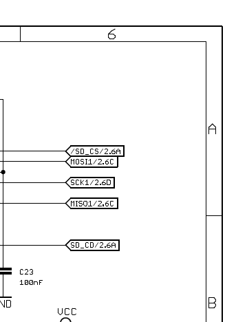

Eagle schematic: Linking signal over different sheets
e14 Contributor
I've seen in schematics, which have frames in it, each net is named with this MOSI1/2.6C . This tells us that the this signal MOSI1 is connected to sheet 2 and the "6C " locates the signal on the sheet using a co-ordinate system. How to do this in Eagle schematic editor? What is the technical names for this part or feature in CAD?

    This requires the use of a "localizer" frame like A4L-LOC.
    You must CHANGE Xref =on , then you can use the label command to
    generate the "flags" to connect to the nets.
