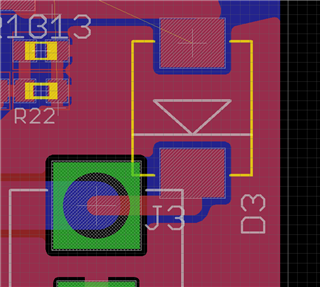

Hello, I suspect this is a question that has been asked and answered before, but my searches for the answer are made difficult by the large number of other discussion topics on other overlapping objects in Eagle. So, apologies in advance if you've already answered/discussed this before - I couldn't find the topic!
The screenshot below shows a large surface mount diode placed next to a through-hole mount connector. The body outlines of these components are shown in white and yellow lines:
The body outlines would suggest that the diode body is going to sit on the through hole pad, and the connector body is going to sit on the surface mount pad. My question is: is this a problem? The bodies themselves aren't close to each other, but are there any issues I should be wary of during reflow soldering or any other process during assembly that would make this a problem?
Clearly in this screenshot there is plenty of space to move the components further apart and avoid this overlap. I just thought I'd use this as clear example to illustrate my question.
Many thanks for any thoughts!

    "Edward Matos"  skrev i nyhetsmeldingen:
    390857746.321422294731114.JavaMail.jive@flmspu-csapp-02.premierfarnell.com
    The short answer is; risk management. It may work or it may not work. You
    better make sure it works before you go on. But if you cant really verify
    it, why take the risk? But its clearly a physical fit problem, not a
    conductor problem. DRC will not complain unless D3 has some keepout area
    over the J3 square pad.
    When looking at the layout, I can't identify the connector (J3) you have
    used, but the big hole that far out on the edge looks suspicious.
    I'm sure there will be a more expert opinion shortly, but...
    I would be cautious of the diode overlapping the through hole pad. There
    would be a risk of capillary bleeding and potentially a short (although
    in this particular case the pads are connected anyway).
    The through-hole connector will usually be fitted later and soldered
    from the other side, so it's not a problem for it to overlap a pad, but
    you can't rely on that in mass production so it would be better to avoid
    that overlap too. Besides, if the soldering of the diode is built up a
    bit (which can happen) then it might foul and prevent the connector
    sitting flush.
    All in all, you may well get away with it but it has a potential to
    cause problems so don't do it.
