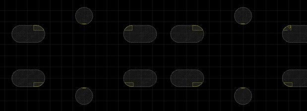

I'm getting a stop mask error. Its on layer 29, tstop. It's for a Omron button and it has labels 1,2,3,4 and I'm wondering if maybe part of those label bled in? I'm not sure what to do. Do I just ignore the error? I highlighted the problem area. Here is just the layer 29image

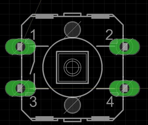

Here is the part with all the layers.

    first, check to see that you don't also have document or tdocu layers turned on.
    Some eagle parts have way too much drawn in the tplace layer. tplace should have exactly what you want on the "silk screen" (aka legend) layer. I like tdocu for info to help me understand part outline and orientation.
    It's easy enough to make a copy of the part and move the offending stuff to the proper layer (tdocu for me). Create the library you want and have it open. Then go to the control panel, expand the libraries section, expand the library that has the bad part, right click on the part and select copy to library. Then go back the lib editor, open the part, figure out which package it uses and edit that. Select change/layer - tdocu and click on the parts that you want on that layer. save the lib, go to the schematic, library/use the new library and then replace the offending parts.

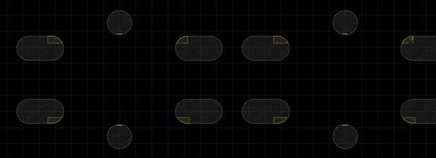

    Strange, when I go into the package, to edit it, the problem area is not
    there.
    You can see in the areas that were a problem, they are not a problem
    here. :/

    I guess that sounds good then.
