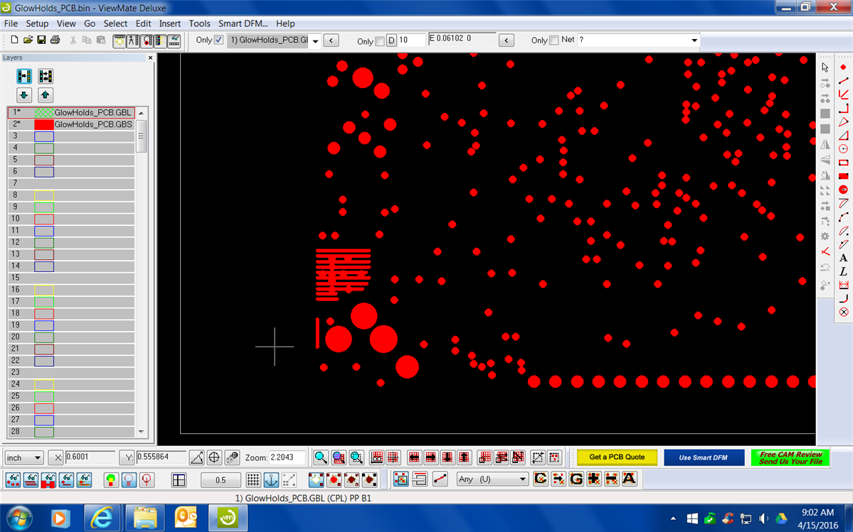

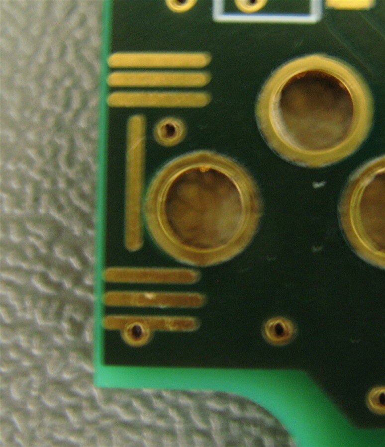

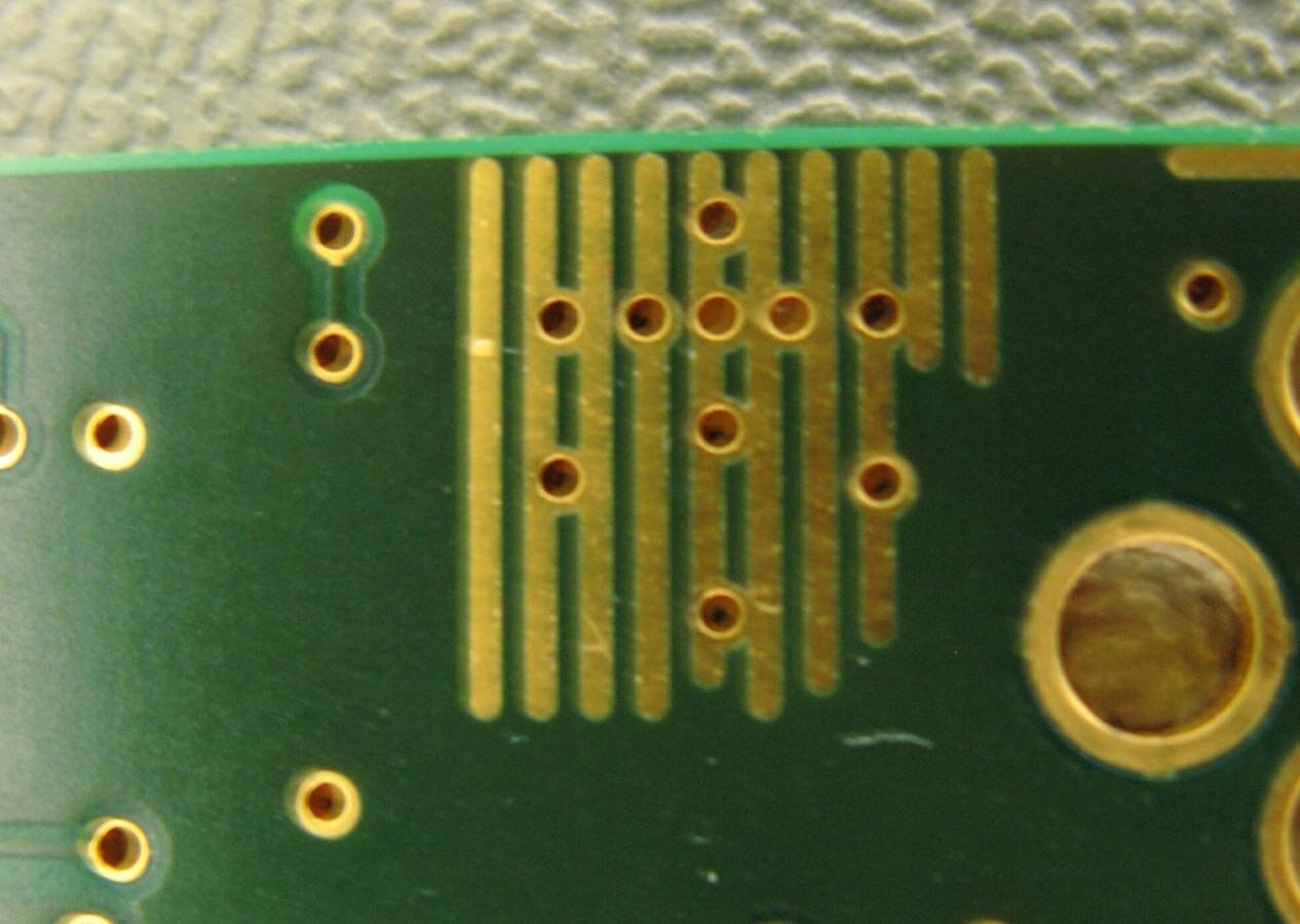

I have an Eagle 7.5 PCB that I am working on.  The solder mask layer on top and bottom have some very strange line openings.  I do not know how they got there, nor do I know how to remove them.  Please see the images below.  They don't seem to be part of any component as if I move the component, they are still there.  Can someone tell me how to remove these?  Thank you!

    If you see it in the Gerber data it is sure that there is something
    drawn in the solder stop layer. If you can not delete them in the layout
    editor in EAGLE it is obviously something that comes from a library.
    What if you try to move on of the components in this area? Do the solder
    stop wires belong to one of the parts there? If yes, you have to check
    the package definition......
    Regards,
    Richard Hammerl

    e14 Contributor over 10 years ago in reply to autodeskguest
    Thank you for that feedback.  It is certainly on the solder mask layer in the bottom left corner.  You can see it clearly.  It seems I can't add the gerber file to this post, so here is a jpg.
    these?  Thank you!
    To be honest, photos of your board are of no use whatever in answering
    the question. We can't tell you what's wrong with your board. If you
    showed us both the Eagle board editor (or posted your .brd file) and the
    Gerber files you sent to the board house, then we would be able to see
    whether the error is in your design, the CAM processing, or a mistake by
    the board house. Without them we can say nothing.
