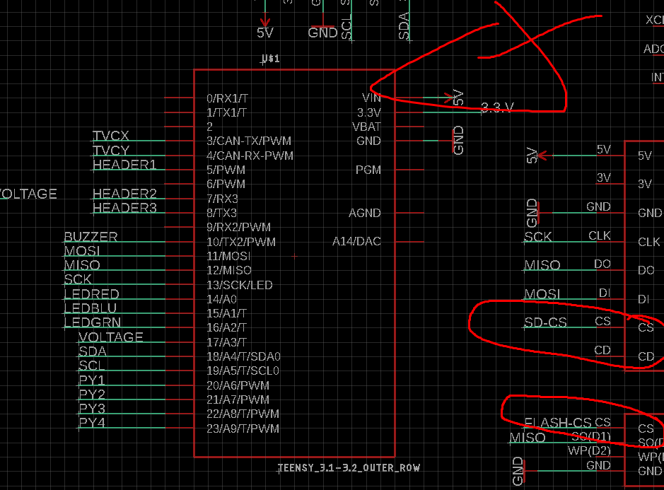

So i'm back for help cause im a starter!!!
I came a cross a problem where i cant make a part with SMD
i want to exactly make a
Serial Flash Memory - W25Q32FV
but in the datesheet it doesnt show to exact lenght and height for the SMD !
How can i came a library for this flash memory and if cant is there something else to use like this one?
Thanks a lot !!!

    On 3/6/20 14:34, george karatzas wrote:
    Sorry if im being annoying but i was wondering how can i connect those CS ports to the teensy board!
    First of all, the CS lines are usually active low.  I see the signals
    SD-CS and FLASH-CS, neither have a bar over them indicating an active
    high status.  Double check the datasheet.  My bet is that they should be
    active low.  To get the bar over the signal name, change the NAME of the
    nets to include a leading bang: "!SD-CS", and "!FLASH-CS".
    As far as connecting them, they're usually connected to a GPIO on the
    microcontroller (uC).  You have at least two devices on the SPI bus, and
    therefore you MUST control the chip selects manually in code.
    Additionally, you'll need to add external pull-up resistors on them -
    anywhere from 47k to 100k should be fine.  A 1/16W resistor should work
    (0402).  The reason for the pull-up is during power-up and power-down.
    The 5V line will ramp up slowly.  Until the uC comes out of
    brown-out-reset (BOR) and the code initializes the specific GPIOs to be
    driven, the GPIO's usually default to high-Z.  But during this process,
    the SPI slave could very easily come out of reset first.  i.e. The +5V
    line reaches the minimum VCC on the slave before it reaches the BOR
    voltage of the uC.  If both slaves come up, the CS lines could very
    easily be below the Vlow and as such would be interpreted as active.  If
    both slaves are active, then both MISO ports are driving the MISO line.
    This is a ripe condition for one slave to drive it high while the other
    slave drives it low.
    This bus contention is solved by adding the pull-up resistors to the CS
    lines.  This assures that the CS is at the same voltage as the +5V line,
    and can not be interpreted as a logic low.  No bus contention.  No blown
    SDO ports.
    Another point to consider, is the voltage on which the GPIOs are
    operating.  I see two power supplies going into the uC - 5V and 3.3V.
    If the GPIOs are operating at 3.3V, it may not be a good thing to drive
    them with a slave that's operating at 5V.  The GPIOs need to be 5V
    tolerant.  Consider the case when the uC is driving the CS, SCK, and
    MOSI.  The minimum Vout-hi on the uC might not be high enough to reach
    the minimum Vin-high (logic high level) on the slaves.  The GPIOs will
    emit about 3.2V.  The slaves may need VDD-1.0.
    On chips that can host different voltages usually have a separate VDDIO
    power pin.  I don't see that on the excerpt image.
  • scuplex
    scuplex over 6 years ago in reply to dukepro
    Thanks a lot! Page 10 is what i was looking for! But couldnt find it!
    Thanks again for the quick reply too! As always the community here is AWESOME!!!!

    dukepro over 6 years ago
    George,
    I'm looking at the datasheet for this.  The length and height are
    published for several packages.  Look in section 10 titled "Package
    Specifications".  Look at dimensions D1 and E1.  You can grab a copy of
    the datasheet at:
    https://www.mouser.com/datasheet/2/813/w25q32fv_revj_06032016-1669822.pdf
    Which package is of interest?  There is likely a matching package in
    smd-ipc.lbr.  Copy this to your library with:
        copy SOP08.pac@smd-ipc.lbr
    Verify the all properties of everything.  Many times you can start with
    something from the library, and tweak it for a specific purpose.  If you
    choose this tweaking route, be sure to rename the package accordingly.
    HTH,
        - Chuck
