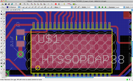

    Hello Ivan,
    Thank you very much for the detailed steps.  I appreciate it!  It all seems to work, but with a few small hiccups. If you have a few more moments perhaps you can give me your feedback on one remaining issue.
    I followed you instructions, but because my ground polygon in on the bottom layer:
    1. I added a bottom layer SMD to my driver chip package.
    2. I named this bottom layer EXP2 (the top one is named EXP as you thought), and
    3. After opening my driver chip as a device, I connected the THERMAL pin to EXP2 pad.
    I want to tie the THERMAL pin to the bottom layer ground polygon. Below is a snapshot of the the TLC on my board. My question is why is my polygon (named GND, and which I would like to merge with the EXP2 pad) prevented from extending under the chip? I can create a wire to extend from EXP2 and the ground polygon (you can just make out the ratsnest wire from pin 33), but somehow the polygon itself is kept out.
    Best Regards,
    Shiva
    PS I'm using a TLC5951. The datasheet suggests connecting the thermal pad to the ground plane to help dissipate more heat.
    e14 Contributor over 13 years ago in reply to e14 Contributor
    Hi Shiva,
    You're welcomed.
    As I can see on the attached screenshot, you're bumping into a clearance limitation (also with trace for pin 35). You made a 4x10 matrix of holes, where each hole includes also a bit wider restricted area. This is the reason why EAGLE hadn't connected GND plane with the polygon - it avoids keep-out regions.
    The solution would be to swap these holes with vias.
    Additionally, check tStop layer if it contains a rectangle and, if needed, (according to your heat dissipation & production goals) delete it.
    Take care,  Ivan.
