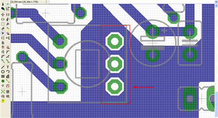

e14 Contributor
hi friendimage
how I will find the centre of hole
In order to I connect the pin with polygon
    toths wrote:
    hi friend Image:test.png
    I dont see any un-routed signal wires (airwires). Is that layer turned off
    or have you created a board without using a schematic?
    If so you will need to run a SIGNAL from that pad to another pad or SMD that
    should be connected. That signal shouold be given the same name as your
    polygon.
    If the board was generated from a schematic, run an ERC check as you may
    have nets that are not connected to the pin in the schematic
    For the polygon to connect to the pin they both have to have the NAME. The
    pin name in this context is the signal name (net name) attached to the pin
    Hope this helps
    Warren
