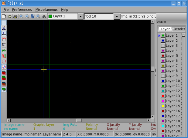

Eagle 7.3.0 on Linux (and quite possible ALL older versions) has a very annoying bug.
When outputting CAM file, the coordinates seem to always be off +0.01 inches in both the X and Y directions..
Here is an example with X/Y offset at 0.5inches
If I subtract an additional 0.01 inches it will line up, but this is clearly a bug. I should not have to do this.
Looking at the output, the offset is not set correctly. It is using an offset of -0.49!

This also happens in the positive direction, or if there is to be no offset at all.
This is the output with a "0" offset. Clearly it is not at zero.

    autodeskguest over 10 years ago in reply to xxxajk +1
    Hi Andrew, I hope you're doing well. I don't think this is a bug, you probably have the pos. coords setting on in the CAM processor. For this setting to work properly all of the tabs within your CAM job…
    Hi Andrew,
    work properly all of the tabs within your CAM job need to have it set
    the same way. (All checked or none checked).
    It basically adds a small offset so that all of your board data is on
    the positive X and Y axis. If you disable the checkbox in your CAM jobs
    you'll see that everything is as you expect.
    hth,
    Jorge Garcia

    xxxajk over 10 years ago in reply to autodeskguest
    Thanks! image
    Why is there a default like this?! Argh :-)
