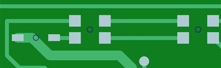

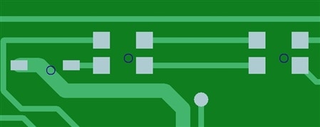

Hello,
I generate the top layer gerber file (using the standard Job gerb274x with offset zero) and the pick and place file using the mountsmd.ulp. No problems here.
But when I load them in my pick and place machine, there is a offset.
The pick and place coordinates are correct, but the gerber is off center (around 0.4mm in x and y)
What i'm doing wrong?
The problem is not the machine, because files generated with other software (tested with  some Protel files) display ok.
Thanks in advance
Joaquim

    In each of your CAM job sections, make sure the "pos. Coord" checkbox is
    clear.  Here's why...
    With "pos. Coord" checked, the CAM Processor will add an offset such
    that all features included in that gerber file are in Quadrant 1, i.e.
    all features have positive coordinates.
    My guess is that you have copper trace around the perimeter of your
    board that's about 0.8 mm wide.  Thus half of the vertical trace is to
    the left of X=0, and half of the horizontal trace is below Y=0.  It
    doesn't have to be a trace - it could be any object or part thereof.
    After the CAM Processor adds offsets, the edge of the trace will be on
    an axis.
    This can cascade into an alignment problem between layers.  For
    instance, if you had such a perimeter trace on the bottom layer, but not
    the top, then the bottom would be offset to make sure the entire trace
    is in Quadrant 1, but the top layer would not have such an offset.  This
    potential pitfall can surface in any layer - mask, inner layers, silk
    screen, etc.
    You can explore this a bit by placing an arbitrary trace on one layer
    that's well to the left of the vertical axis, run the CAM Processor,
    then look at the gerber file.  Try this with "pos. Coord" turn on, then
    again with it turned off.
    As you noted, the pick-and-place coordinates are correct because they
    were obtained through a means other than the CAM Processor.
    HTH,
        - Chuck

    Chuck,
    Bullseye !!  Thank you very much!
